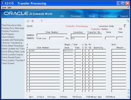

To enter location information without inquiry
  1. On Transfer Processing, complete the following fields:
    • To (Location)
    • Equipment Number (Item Number)
    Figure 19-1 Transfer Processing screen
    Description of Figure 19-1 follows
    Description of "Figure 19-1 Transfer Processing screen"
  2. Complete the following optional fields:
    • Date
    • Time
    • From (Location)
    • Transfer Number
  3. To enter location information, complete the following optional fields:
    • Equipment Status
    • Beginning Date
    • Beginning Time
  4. To enter additional location information, choose More Details (F4).
    Figure 19-2 Transfer Processing screen's More Details view
    Description of Figure 19-2 follows
    Description of "Figure 19-2 Transfer Processing screen's More Details view"
