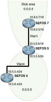

Stub Area, ASBR, and Route Redistribution Topology Example
image:Figure showing stub area, ASBR, and route redistribution example topology
You must configure switches SEFOS4, SEFOS5, and SEFOS7 for OSPF. See Configuration Guidelines for more information.
