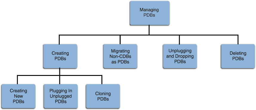

Figure 39-1 provides a graphical overview of how you can manage the PDB lifecycle in Cloud Control.
You can provision PDBs by creating a new PDB within a CDB, by cloning an existing PDB, or by migrating existing non-CDBs to a CDB as PDBs. You can also use unplugged PDBs for provisioning, by plugging them into a CDB.
As an alternative to using the methods described in this section, you can use Enterprise Manager Command Line Interface (EM CLI) to provision PDBs. For more information, see Oracle® Enterprise Manager Lifecycle Management Administrator's Guide.
