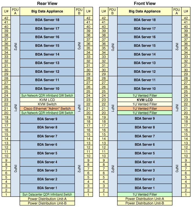

Figure E-1 shows the front and rear layout of an Oracle Big Data Appliance rack.
Figure E-1 Rack Layout of Oracle Big Data Appliance
