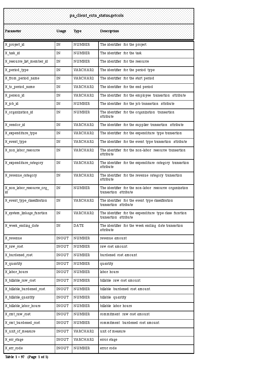

The following table lists the parameters that Oracle Projects provides for the API, pa_accum_api.get_project_accum_actuals. (See files PAAAPIS.pls and PAAAPIB.pls under the admin directory.)

Using the Identifier for the Task
When retrieving project-level amounts, this parameter can be null.
Using the Identifier for the Resource
When retrieving aggregate project or task amounts, this parameter can be null.
Using the Identifier for the Period Type
You use this parameter to tell the procedure that you are expect summary amounts by either Oracle Projects or Oracle General Ledger period. Allowable values are as follows:
- 'P' for Oracle Projects Period
- 'G' for Oracle General Ledger Period
Using the From-Period Names and To-Period Names
You must pass these two parameters to the procedure with the following constraints:
- If the period type is Oracle Projects Period, then both period names must be Oracle Projects period names. Otherwise, Oracle General Ledger period names must be used for both parameters
- If you are retrieving amounts for one period, you must specify the same period name for both parameters
- For a range of periods, the from period name must be earlier than the to period name
