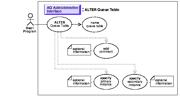

Alter a Queue Table
Figure 9-4 Use Case Diagram: Alter a Queue Table
To refer to the table of all basic operations having to do with the Administrative Interface see:
Purpose
Alter the existing properties of a queue table.
Usage Notes
Not applicable.
