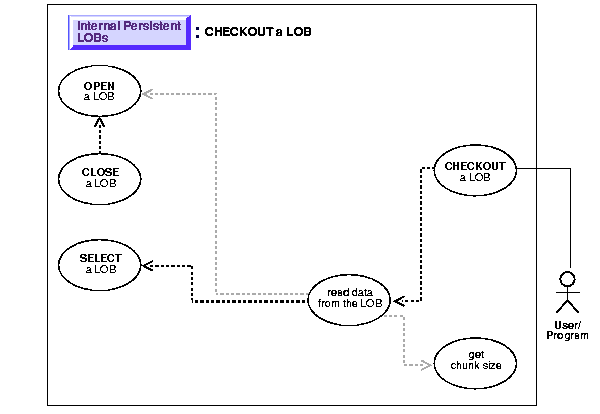

This procedure describes how to checkout a LOB.
The most efficient way to read large amounts of LOB data is to use OCILobRead
() with the streaming mechanism enabled via polling or callback. Use OCI or PRO*C interfaces with streaming for the underlying read operation. Using DBMS_LOB
.READ
will result in non-optimal performance.
See Chapter 3, "LOB Programmatic Environments" for a list of available functions in each programmatic environment. Use the following syntax references for each programmatic environment:
In the typical use of the checkout-checkin operation, the user wants to checkout a version of the LOB from the database to the client, modify the data on the client without accessing the database, and then in one fell swoop, checkin all the modifications that were made to the document on the client side.
