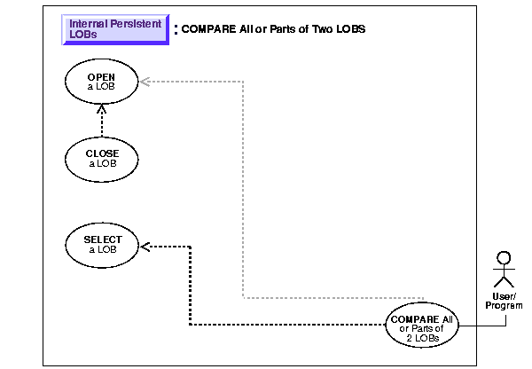

See: "Use Case Model: Internal Persistent LOBs Basic Operations", for all basic operations of Internal Persistent LOBs.: |
This procedure describes how to compare all or part of two LOBs.
