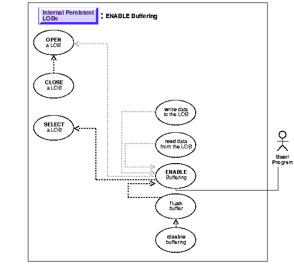

Figure 9-38 Use Case Diagram: Enable LOB Buffering
See:
"Use Case Model: Internal Persistent LOBs Basic Operations", for all basic operations of Internal Persistent LOBs.
Purpose
This procedure describes how to enable LOB buffering.
Usage Notes
Enable buffering when performing a small read or write of data. Once you have completed these tasks, you must disable buffering before you can continue with any other LOB operations.
  • You must flush the buffer in order to make your modifications persistent.
  • Do not enable buffering for the stream read and write involved in checkin and checkout.
For more information, refer to "LOB Buffering Subsystem" in Chapter 5, "Advanced Topics".
