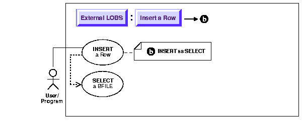

This procedure describes how to INSERT a row containing a BFILE by selecting a BFILE from another table.
With regard to LOBs, one of the advantages of utilizing an object-relational approach is that you can define a type as a common template for related tables. For instance, it makes sense that both the tables that store archival material and the working tables that use those libraries share a common structure. See the following "Scenario".
See the following syntax reference:
The following code fragment is based on the fact that a library table VoiceoverLib_tab
is of the same type (Voiced_typ
) as Voiceover_tab
referenced by column Voiced_ref
of Multimedia_tab
table.
It inserts values from the library table into Multimedia_tab
by means of a SELECT
The example is provided in SQL and applies to all programmatic environments:
INSERT INTO Voiceover_tab (SELECT * from VoiceoverLib_tab WHERE Take = 12345);
