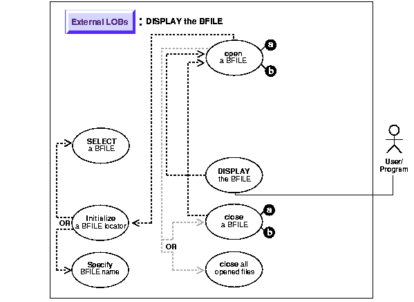

This procedure describes how to display BFILE data.
Not applicable.
See Chapter 3, "LOB Programmatic Environments" for a list of available functions in each programmatic environment. Use the following syntax references for each programmatic environment:
These examples open and display BFILE data.
Examples are provided in six programmatic environments:
