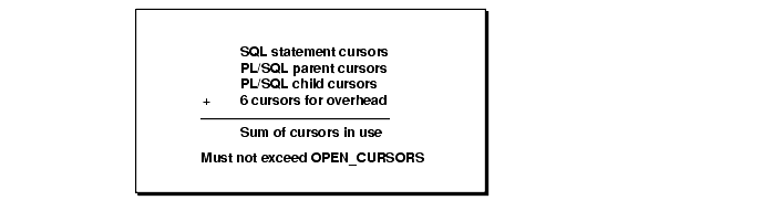

The maximum number of cursors your program cans use simultaneously is determined by the database initialization parameter OPEN_CURSORS. Normally, the precompiler allows management of statement cursors, to prevent OPEN_CURSORS being exceeded, using the precompiler options HOLD_CURSOR, RELEASE_CURSOR and MAXOPENCURSORS (For more details on this subject, see "Embedded PL/SQL Considerations".). While executing an embedded PL/SQL block there will be one cursor, the parent cursor, associated with the entire PL/SQL block and a separate child cursor for each statement executed during the execution of the PL/SQL block. Because the PL/SQL block is passed to the server for execution, only the parent cursor can be tracked by the precompiler runtime library and so it is possible for applications that use a lot of cursors in this way to exceed OPEN_CURSORS. Figure 6-1 shows how to calculate the maximum number of cursors used.
Developers should be aware of this situation and plan for this in the setting of OPEN_CURSORS and MAXOPENCURSORS.
If there are problems with this, you may wish to free all child cursors after a SQL statement is executed.
This can be achieved by setting RELEASE_CURSOR=YES and HOLD_CURSOR=NO. Due to the fact that the use of the first setting for the entire program is likely to have an impact on performance, you can set these options in line as follows:
