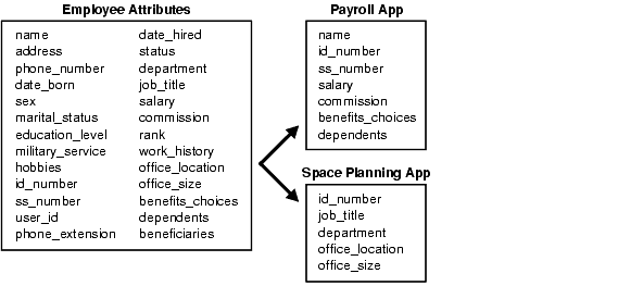

Suppose you must write a program to allocate employee bonuses. Not all employee attributes are needed to solve this problem. So, you design an abstract employee who has the following problem-specific attributes: name, ID number, department, job title, salary, and rank. Then, you identify the operations needed to handle an abstract employee. For example, you need an operation that lets Management change the rank of an employee.
Next, you define a set of variables (attributes) to represent the data, and a set of subprograms (methods) to perform the operations. Finally, you encapsulate the attributes and methods in an object type.
The data structure formed by the set of attributes is public (visible to client programs). However, well-behaved programs do not manipulate it directly. Instead, they use the set of methods provided. That way, the employee data is kept in a proper state.

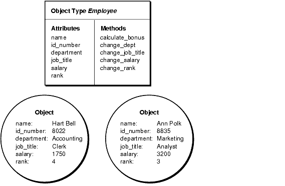

At run time, when the data structure is filled with values, you have created an instance of an abstract employee. You can create as many instances (usually called objects) as you need. Each object has the name, number, job title, and so on of an actual employee (see Figure 9-2). This data is accessed or changed only by the methods associated with it. Thus, object types let you create objects with well-defined attributes and behavior.
Figure 9-2 Object Type and Objects (Instances) of that Type

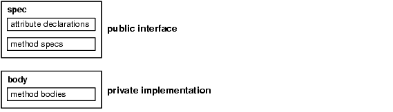

Like a package, an object type has two parts: a specification and a body (refer to Figure 9-3). The specification (spec for short) is the interface to your applications; it declares a data structure (set of attributes) along with the operations (methods) needed to manipulate the data. The body fully defines the methods, and so implements the spec.
Figure 9-3 Object Type Structure
All the information a client program needs to use the methods is in the spec. Think of the spec as an operational interface and of the body as a black box. You can debug, enhance, or replace the body without changing the spec--and without affecting client programs.
