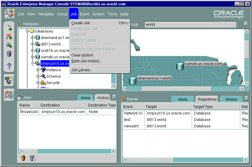

The Job menu allows you to create, modify, save, submit, and manage jobs. The menu options are enabled depending on the items selected in the Job pane. See Figure 4-1, "Job Pane in the Console" for an illustration of the Job menu.
Allows you to create a new job. See "Creating, Modifying, or Viewing a Job" on page 4-11 for more information.
Allows you to create a new job like the selected job in the Job pane. See "Creating, Modifying, or Viewing a Job" on page 4-11 for more information.
Allows you to modify the job selected in the Job pane. The property sheet is the same as the property sheet for creating a new job. See "Creating, Modifying, or Viewing a Job" on page 4-11 for more information.
Copies the selected job to the Job Library if it does not already exist there.
Displays the property sheet for the selected job in the Job pane. The property sheet is in read-only format. Active jobs can be removed but not modified. See "Creating, Modifying, or Viewing a Job" on page 4-11 for more information.
Removes the selected job from the Active or History page of the Job pane. When you delete a job, there is usually a slight delay while the request is processed. See "Cancelling Jobs" on page 4-5 for specifics on job cancellation.
Displays the Job Library dialog. See "Job Library" on page 4-11 for more information.
Saves the contents of the Job History page to a text file. Enter a valid file name or select an existing file in the file selection dialog box.
Clears the jobs listed in the Job History page.
Clears the selected job listed in the Job History page.

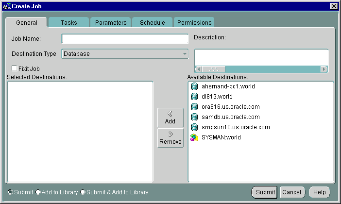

To view the details of a particular job, double-click on a job in the Job window. The Job property sheet for that job appears.
The General page allows you to determine job name, description, type, fixit job status, and destinations.
Select the owner from the list of administrators.
Enter the name of the new job.
Enter the description of the job.
Check this box if you want to use this job as fixit job to correct an event condition. The fixit job must be submitted to the destination where the event is being monitored. A fixit job cannot be scheduled.
The job can be selected from the Fixit Job list in the Event Parameters page after it has been successfully submitted to an Intelligent Agent. See "Creating, Modifying, and Registering an Event" on page 5-24 for more information.
Select the destination type from the pull-down list: Database, Listener, Node, Group, or other service that is integrated into the Console.
Select the destinations of the job in the Available Destinations list and click the << (Add) button to move the destination to the Selected Destinations list.
The destinations are determined by the Destination Type. The destinations include databases, listeners, nodes, and groups of these objects.
Only network objects that have been discovered correctly and have an Intelligent Agent running are included in the list of available destinations. See "Discovering Services" on page 2-7 for more information.

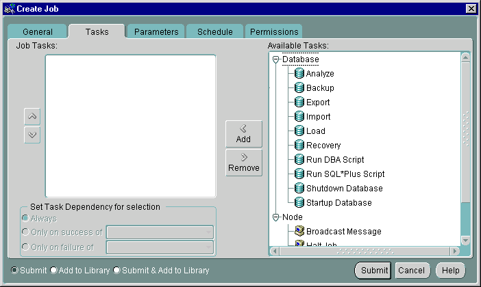

The Task page allows you to choose the tasks that you want the job to perform.
Select a task and click on the << (Add) button to include the task in the job. You can add multiple tasks to the job from the Available Tasks scrolling list. See the online help for Oracle job tasks and "Oracle Job Tasks" on page 4-23 for information on Oracle predefined job tasks and their parameters.
You can remove tasks from this list. Select the task and click on the >> (Remove) button.
Use the arrow buttons to change the order of the tasks or to make a task conditional on a previous task. You can change the order in which the tasks are executed. Select a task in the Selected Tasks list and click on the up or down arrow button to position the task.
Select a task in the Job Tasks window and select from the following:
If any task does not execute, control moves to the next task on the same level as the task that did not execute.
Important: You can add up to five job tasks per job. Adding more than five tasks will generate an error message stating the maximum number of input files have been exceeded. |
Normally, a job stops when all tasks have been executed. In some cases, you may want the job to stop before completing the task sequence, which might be the case when one task in the sequence fails. To handle situations like this, you can include the Halt Job task as part of a composite job to stop execution at any point within the task sequence. You specify the Halt Job task dependency as you would any other task.

This section lists the Oracle predefined job tasks and parameters for:
This information is entered in the Job Task Page and Job Parameters Page of the Create Job property sheet. The name and the parameters are listed for each task.
These are the tasks that can be run on databases and database groups. In addition, you can run operating system or host job tasks.
You need to set up a password file to perform administration tasks on a remote database. See the Oracle Enterprise Manager Configuration Guide for more information.
Specific database job tasks are used by the Enterprise Manager data and backup management wizards that are accessed through the Console Navigator popup and main menus. The job tasks are:
Since these job tasks are used only by their respective wizards, the tasks will not have directly editable parameters. To modify parameters for any Wizard database task, click on the Details button located on the Parameters page of the Job property sheet to activate the associated Wizard. For more information about these wizards and associated job tasks, see the Enterprise Manager online help.
This job executes a SQL*Plus script, allowing any legal SQL or PL/SQL scripts to be run, including all SQL*Plus formatting commands. You can copy and paste the text of the script into the Script Text box of the Parameters page (Create Job property sheet), or simply type SQL commands in the Script Text box.
See "Preferred Credentials" on page 1-18 for more information.
If you need to determine whether a SQL error has occurred during the running of a SQL script, include "WHENEVER SQLERROR EXIT SQL.SQLCODE" at the beginning of the script. If a SQL error occurs, the job status is set to failed.
This job executes a Server Manager line mode script that contains DBA commands.
This job task shuts down an Oracle database instance.
This job task starts up an Oracle database instance.
/private/oracle/admin/ora8db/myinit.ora
If you do not enter a filename, the default platform-specific initialization file is used.
