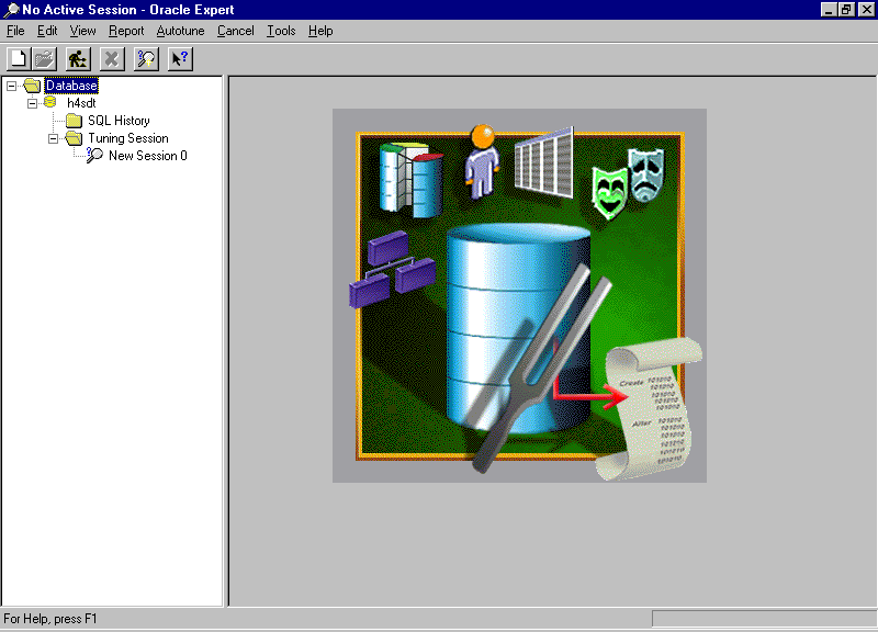

Oracle Expert Main Window
When you launch Oracle Expert, the Oracle Expert main window displays, as shown in Figure 10-1. Click F1 from this page for more information.
Figure 10-1 Oracle Expert Main Window
The window consists of menus, panes, a toolbar, and a status bar. Use the menus and toolbar to access Oracle Expert functionality. The status bar provides information relating to the task you are performing.
