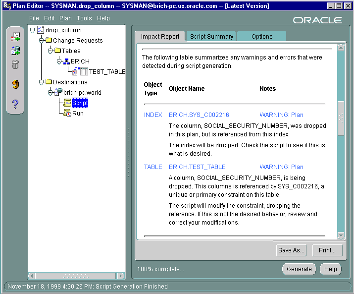

  4. Click the Generate button to generate the script for the destination database. Work-in-progress messages display while the script is being generated.
Figure 3-5 shows a fully expanded change plan in Plan Editor with the Script subobject selected.
Figure 3-5 A Fully Expanded Change Plan
Viewing the Impact Report and Script Summary with Plan Editor
Oracle Change Management Pack creates an impact report when it generates the script. You should view the impact report to determine the impact of executing the script at the destination database. The impact report provides a summary of the number and types of objects that will be modified when the script executes at the destination database. The impact report also shows warnings and errors, including a description of the requested operations that cannot be performed at the destination database, for example, a request to drop a column that no longer exists at the destination database.
After generating the script, you should view the impact report and script summary. You can also edit the script.
A script that has been edited can be executed even if it has script generation errors.
If the impact report or the script summary is unacceptable, you can take one or more of the following actions:
