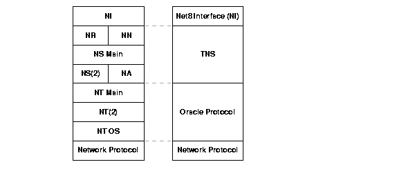

Log files provide information contained in an error stack. An error stack refers to the information that is produced by each layer in an Oracle communications stack as the result of a network error.
Figure 12-1 depicts the relationship among Oracle network products as they might appear in an error stack.
The layers in Figure 12-1 are as follows:
Your network may or may not include all of these components.
As an example, suppose that a user of a client application tries to establish a connection with a database server using Net8 and TCP/IP, and the user enters:
sqlplus scott/tiger@hrserver.com
The SQL*Plus banner is displayed on the screen, and the following error is displayed:
ORA-12203: TNS:Unable to connect to destination
This message indicates that the connection to the server failed because the database could not be contacted. Although the application displays only a one-line error message, an error stack that is much more informative is recorded in the log file by the network layer. On the client-side, a log file called sqlnet.log
, contains an error stack corresponding to the ORA-12203
error as follows:
Fatal OSN connect error 12203, connecting to: (DESCRIPTION=(CONNECT_DATA=(SID=trace)(CID=(PROGRAM=) (HOST=lala)(USER=sviavant)))(ADDRESS_LIST=(ADDRESS= (PROTOCOL=ipc)(KEY=trace))(ADDRESS=(PROTOCOL=tcp) (HOST=lala)(PORT=1521)))) VERSION INFORMATION: TNS for SunOS: Oracle Bequeath NT Protocol Adapter for SunOS: Unix Domain Socket IPC NT Protocol Adaptor for SunOS: TCP/IP NT Protocol Adapter for SunOS: Tracing to file: /home/sviavant/trace_admin.trc Tns error struct: nr err code: 12203 TNS-12203: TNS:unable to connect to destination ns main err code: 12541 TNS-12541: TNS:no listener ns secondary err code: 12560 nt main err code: 511 TNS-00511: No listener nt secondary err code: 61 nt OS err code: 0
