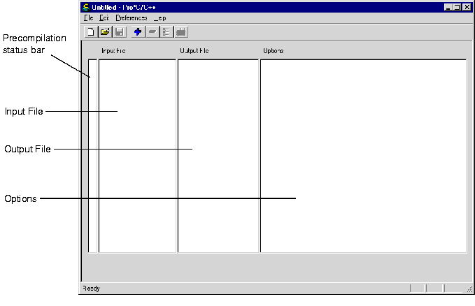

The Pro*C/C++ precompile environment contains five elements noted in the following illustration:
Title Bar
The title bar displays the name of the Pro*C/C++ project. If you have not assigned a name to the current project, the word "Untitled" appears instead.
Menu Bar
The menu bar contains the following menus:
Menu  Description
File
Contains commands to create a new Pro*C/C++ project, open an existing Pro*C/C++ project, save the active Pro*C/C++ project under the same name or under a different name, specify a connect string to an Oracle database, precompile a Pro*C/C++ project, and exit the application.
Edit
Contains commands to add files to a Pro*C/C++ project, delete files from a Pro*C/C++ project, and display or change precompiler options.
Preferences
Contains commands to set the default file extension of output files.
Help
Contains the About Pro*C/C++ command, which displays the version number of the application and copyright information.

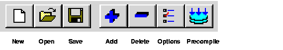

Toolbar
The toolbar enables you to execute commands by clicking a button:
Button  Description
New
Create a new Pro*C/C++ project
Open
Open an existing Pro*C/C++ project
Save
Save the active Pro*C/C++ project under the same name
Add
Add files to a Pro*C/C++ project
Delete
Delete files from a Pro*C/C++ project
Options
Display or change precompiler options
Precompile
Precompile a Pro*C/C++ project
Information Pane
The information pane consists of four elements noted in the following illustration:
Element  Description
Precompilation Status Bar
Indicates whether the precompilation for a file was successful or unsuccessful.
Input File
Shows the files of a Pro*C/C++ project to be precompiled.
Output File
Shows the output files of a Pro*C/C++ project after precompilation.
Options
Displays precompile options that are different from the default options.
Look for one of the three status icons in the precompilation status bar after the precompile process is complete.
Double clicking a status icon opens the Precompilation Status dialog box. This dialog box provides detailed information on the reason for a warning or failure.
Status Bar
The status bar at the bottom of the window displays information about the progress of a precompilation. The status bar also identifies the purpose of a toolbar button or menu command when you place the mouse pointer over the toolbar button or menu command.

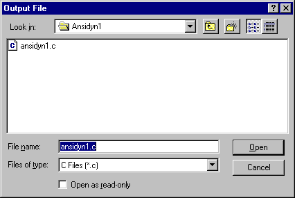

Changing the Name of an Existing Input or Output File
To change the name of an existing input or output file:
  1. Double-click the file name in the Input File or Output File area of the information pane. The Input File or Output File dialog box appears.
  2. Replace the old file name with the new file name.
  3. Click Open.

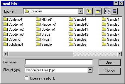

Adding Files to the Project
To add files to the project:
  1. Choose Edit > Add. The Input File dialog box appears.
  2. Select one or more .pc files. Use the Ctrl key and the mouse to select files that are not adjacent.
  3. Click Open. The selected files appear in the information pane.

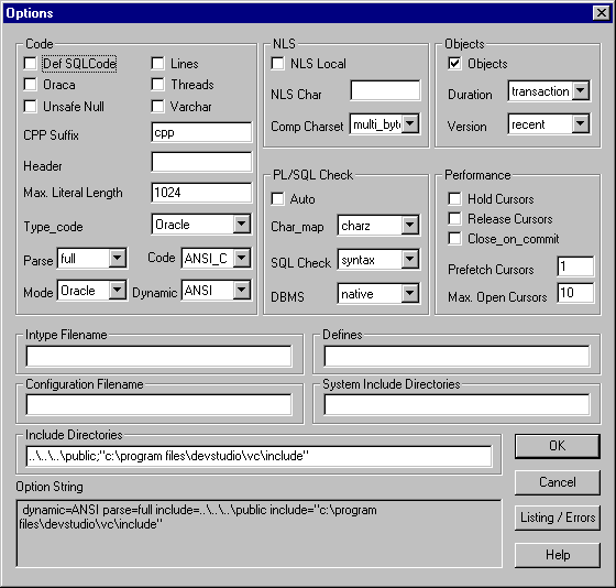

Setting the Precompiler Options
The Precompiler options enable you to control how resources are used, how errors are reported, how input and output are formatted, and how cursors are managed.
To set the precompile options:
  1. Select one or more files in the Input File list.
  2. Choose Edit > Options. The Options dialog box appears.
    Default options are in effect for all newly added files. When you change an option's default setting, a description of the change appears in the Option String edit field at the bottom of the Options dialog box and in the Options area of the information pane. For additional information on options, see "Precompiler Options".

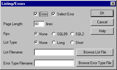

  3. To change the format of the output list file that the precompiler writes to disk, click the Listing / Errors button. The Listing/Errors dialog box appears.
    The settings include the type of error information generated and the name of the list file.
  4. After you set the options in the Options dialog box, click OK.

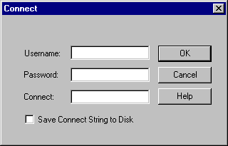

Specifying Database Connection Information
If you selected semantics or full for the SQL Check option in the Options dialog box, you may need to specify database connection information to the Oracle database. You do not need to connect to the Oracle database if every table referenced in a data manipulation statement or PL/SQL block is defined in a DECLARE TABLE statement.
To specify database connection information:
  1. Choose File > Connect. The Connect dialog box appears.
  2. Use this dialog box to specify database connection information prior to precompiling. No database connection is performed at this time. Only one set of database connection information can be specified for all files requiring semantic or full SQLCHECKing.
  3. The Connect dialog box appears automatically at precompile time if you have not previously responded. Enter the user name, the password, and the network service name (database alias). The network service name is not required for a local database.
  4. If you want to save the connection information between Pro*C/C++ sessions, select the Save Connect String to Disk check box. If you do not select the check box, you must enter this information each time you precompile.
  5. Click OK.

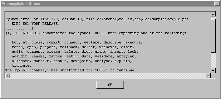

Checking the Results
Precompiling can result in success, success with warning(s), or failure. When precompiling is finished, check the precompilation status bar.
Fixing Errors
If you see a yellow check or a red X, double-click the icon in status bar. The Precompilation Status dialog box appears. This dialog box lists warning messages or reasons why the precompilation failed. For example:
Switch to your development environment to fix the problem(s). After you correct the errors, precompile again.
If you receive a PCC-S-02014 error (syntax error at line num, column colnam, file name), do the following:
  • Copy the batch files mod_incl.bat and add_newl.bat from the oracle_base\oracle_home\precomp\misc\proc directory to the directory that contains the problematic INCLUDE file.
  • Run mod_incl.bat.
