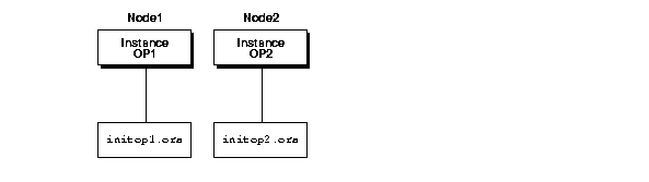

An initialization parameter file is an ASCII text file containing a list of parameters.
In Oracle Parallel Server, some initialization parameters must be identical across all instances. Other parameters, however, can have unique values within each instance. Oracle accommodates both common and unique parameter settings by grouping these parameters into two files, the common (init
db_name
.ora
) and instance-specific (init
sid.ora
file) parameter files. If you used Oracle Database Configuration Assistant, these file are already established.
The init
sid.ora
file uses the IFILE parameter to point to the init
db_name
.ora
file for common parameters. The init
sid.ora
file defines the following for each instance:
The sid is the value of the DB_NAME parameter in the init
db_name
.ora
file and the thread ID. For instance, if the DB_NAME is op
, and the first instance has a thread ID of 1, its SID is op1
; the second instance uses the SID op2
to identify its instance; and so on.
Example 4-1 and Example 4-2 show the contents of init
sid
.ora
files for two instances with node numbers of 1 and 2 that Oracle Database Configuration Assistant created:
ifile='C:\OracleSW\admin\op\pfile\initop.ora' rollback_segments=(rbs1_1,rbs1_2) thread=1 parallel_server=true instance_name=op1 remote_login_passwordfile=exclusive
ifile='C:\OracleSW\admin\op\pfile\initop.ora' rollback_segments=(rbs2_1,rbs2_2) thread=2 parallel_server=true instance_name=op2 remote_login_passwordfile=exclusive
