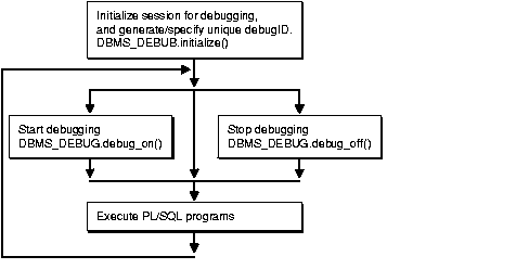

Figure 8-1 Target Session

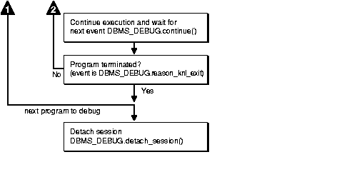

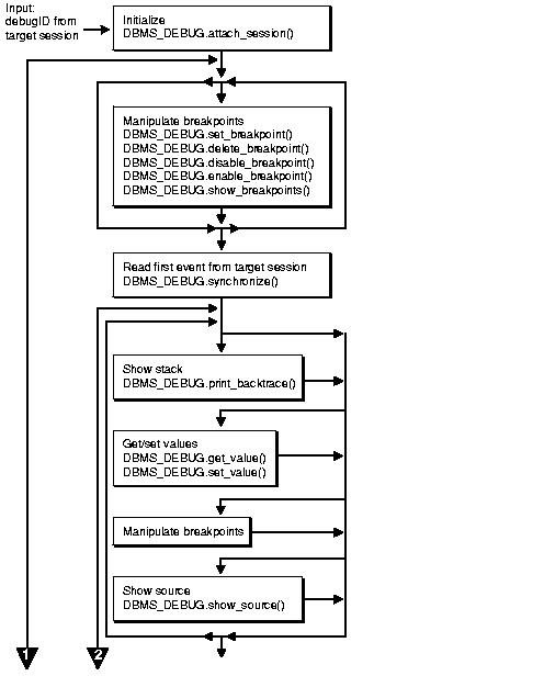

Figure 8-2 Debug Session
Figure 8-2 Debug Session (Cont.)
