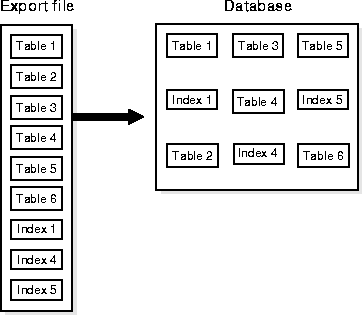

Figure 2-1 illustrates the process of importing from an Export dump file.
Figure 2-1 Importing an Export File

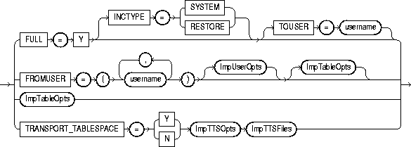

Import Modes
The Import utility provides four modes of import. The objects that are imported depend on the Import mode you choose and the mode that was used during the export. All users have two choices of import mode. A user with the
IMP_FULL_DATABASE role (a privileged user) has four choices:
TABLES
This mode allows you to import specific tables and partitions. A privileged user can qualify the tables by specifying the schema that contains them.
FROMUSER
This mode allows you to import all objects that belong to you (such as tables, grants, indexes, and procedures). A privileged user importing in user mode can import all objects in the schemas of a specified set of users.
FULL
Only users with the IMP_FULL_DATABASE role can import in this mode, which imports a full database export dump file.
TRANSPORT_TABLESPACES
This mode allows a privileged user to move a set of tablespaces from one Oracle database to another.
See Import Parameters for information on specifying each mode.
A user with the IMP_FULL_DATABASE role must specify one of these options or specify an incremental import. Otherwise, an error results. If a user without the IMP_FULL_DATABASE role fails to specify one of these options, a user-level import is performed.

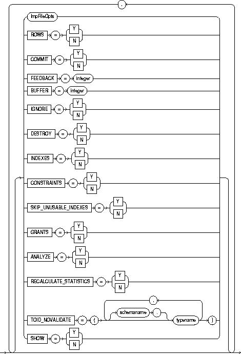

Keyword  Description (Default)       Keyword      Description (Default)
USERID   username/password           FULL         import entire file (N)
BUFFER   size of data buffer         FROMUSER     list of owner usernames
FILE     input files (EXPDAT.DMP)    TOUSER       list of usernames
SHOW     just list file contents (N) TABLES       list of table names
IGNORE   ignore create errors (N)    RECORDLENGTH length of IO record
GRANTS   import grants (Y)           INCTYPE      incremental import type
INDEXES  import indexes (Y)          COMMIT       commit array insert (N)
ROWS     import data rows (Y)        PARFILE      parameter filename
LOG      log file of screen output   CONSTRAINTS  import constraints (Y)
DESTROY  overwrite tablespace data file (N)
INDEXFILE write table/index info to specified file
SKIP_UNUSABLE_INDEXES  skip maintenance of unusable indexes (N)
ANALYZE  execute ANALYZE statements in dump file (Y)
FEEDBACK display progress every x rows(0)
TOID_NOVALIDATE  skip validation of specified type ids
FILESIZE maximum size of each dump file
RECALCULATE_STATISTICS recalculate statistics (N)
VOLSIZE  number of bytes in file on each volume of a file on tape
The following keywords only apply to transportable tablespaces
TRANSPORT_TABLESPACE import transportable tablespace metadata (N)
TABLESPACES tablespaces to be transported into database
DATAFILES datafiles to be transported into database
TTS_OWNERS users that own data in the transportable tablespace set

Manually Ordering the Import
When the constraints are reenabled after importing, the entire table is checked, which may take a long time for a large table. If the time required for that check is too long, it may be beneficial to order the import manually.
To do so, perform several imports from an export file instead of one. First, import tables that are the targets of referential checks. Then, import the tables that reference them. This option works if tables do not reference each other in circular fashion, and if a table does not reference itself.

The following diagrams show the syntax for the parameters that you can specify in the parameter file or on the command line.
Import_start
ImpModes

ImpOpts
ImpFileOpts

ANALYZE
Default: Y
Specifies whether or not the Import utility executes SQL ANALYZE statements found in the export file or loads optimizer statistics for tables, indexes, and columns that were precomputed on the Export system. See also the Import parameter RECALCULATE_STATISTICS and Importing Statistics.
BUFFER
Default: operating system-dependent
The buffer-size is the size, in bytes, of the buffer through which data rows are transferred.
The parameter BUFFER (buffer size) determines the number of rows in the array inserted by Import. The following formula gives an approximation of the buffer size that inserts a given array of rows:
buffer_size = rows_in_array * maximum_row_size
For tables containing LONG, LOB, BFILE, REF, ROWID, LOGICAL ROWID, DATE, or type columns, rows are inserted individually. The size of the buffer must be large enough to contain the entire row, except for LOB and LONG columns. If the buffer cannot hold the longest row in a table, Import attempts to allocate a larger buffer.
Additional Information: See your Oracle operating system-specific documentation to determine the default value for this parameter.
CHARSET
Note: This parameter applies to Oracle Version 5 and 6 export files only. Use of this parameter is not recommended. It is provided only for compatibility with previous versions. Eventually, it will no longer be supported. See The CHARSET Parameter if you still need to use this parameter.
COMMIT
Default: N
Specifies whether Import should commit after each array insert. By default, Import commits only after loading each table, and Import performs a rollback when an error occurs, before continuing with the next object.
If a table has nested table columns or attributes, the contents of the nested tables are imported as separate tables. Therefore, the contents of the nested tables are always committed in a transaction distinct from the transaction used to commit the outer table.
If COMMIT=N and a table is partitioned, each partition and subpartition in the Export file is imported in a separate transaction.
Specifying COMMIT=Y prevents rollback segments from growing inordinately large and improves the performance of large imports. Specifying COMMIT=Y is advisable if the table has a uniqueness constraint. If the import is restarted, any rows that have already been imported are rejected with a nonfatal error.
If a table does not have a uniqueness constraint, Import could produce duplicate rows when you reimport the data.
For tables containing LONG, LOB, BFILE, REF, ROWID, UROWID, DATE, or type columns, array inserts are not done. If COMMIT=Y, Import commits these tables after each row.
CONSTRAINTS
Default: Y
Specifies whether or not table constraints are to be imported. Note that the default is to import constraints. If you do not want constraints to be imported, you must set the parameter value to N.

FEEDBACK
Default: 0 (zero)
Specifies that Import should display a progress meter in the form of a dot for n number of rows imported. For example, if you specify FEEDBACK=10, Import displays a dot each time 10 rows have been imported. The FEEDBACK value applies to all tables being imported; it cannot be set on a per-table basis.

FULL
Default: N
Specifies whether to import the entire export file.

IGNORE
Default: N
Specifies how object creation errors should be handled. If you specify IGNORE=Y, Import overlooks object creation errors when it attempts to create database objects and continues without reporting the errors. Even if IGNORE=Y, Import will not replace an existing object; instead, it will skip the object.
If you accept the default, IGNORE=N, Import logs and/or displays the object creation error before continuing.
For tables, IGNORE=Y causes rows to be imported into existing tables. No message is given. If a table already exists, IGNORE=N causes an error to be reported, and the table is skipped with no rows inserted. Also, objects dependent on tables, such as indexes, grants, and constraints, will not be created if a table already exists and IGNORE=N.
Note that only object creation errors are ignored; other errors, such as operating system, database, and SQL errors, are not ignored and may cause processing to stop.
In situations where multiple refreshes from a single export file are done with IGNORE=Y, certain objects can be created multiple times (although they will have unique system-defined names). You can prevent this for certain objects (for example, constraints) by doing an import with the value of the parameter CONSTRAINTS set to N. If you do a full import with the CONSTRAINTS parameter set to N, no constraints for any tables are imported.
If you want to import data into tables that already exist--perhaps because you want to use new storage parameters, or because you have already created the table in a cluster--specify IGNORE=Y. The Import utility imports the rows of data into the existing table.
Caution: When you import into existing tables, if no column in the table is uniquely indexed, rows could be duplicated if they were already present in the table. (This applies to nonincremental imports only. Incremental imports replace the table from the last complete export and then rebuild it to its last backup state from a series of cumulative and incremental exports.)
INCTYPE
Default: undefined
Specifies the type of incremental import.
The options are:
SYSTEM
Imports the most recent version of system objects. You should specify the most recent incremental export file when you use this option. A SYSTEM import imports system objects such as foreign function libraries and object type definitions, but does not import user data or objects.
RESTORE
Imports all user database objects and data contained in the export file, excluding system objects.

INDEXES
Default: Y
Specifies whether or not to import indexes. System-generated indexes such as LOB indexes, OID indexes, or unique constraint indexes are re-created by Import regardless of the setting of this parameter.
You can postpone all user-generated index creation until after Import completes, by specifying INDEXES=N.
If indexes for the target table already exist at the time of the import, Import performs index maintenance when data is inserted into the table.
Default: N
Setting this parameter to Y will cause database optimizer statistics to generate when the exported data is imported. See Oracle8i Concepts for information about the optimizer and the statistics it uses. See also the Export parameter STATISTICS, the Import parameter ANALYZE, and Importing Statistics.

ROWS
Default: Y
Specifies whether or not to import the rows of table data.
SHOW
Default: N
When SHOW=Y, the contents of the export file are listed to the display and not imported. The SQL statements contained in the export are displayed in the order in which Import will execute them.
The SHOW parameter can be used only with the FULL=Y, FROMUSER, TOUSER, or TABLES parameters.
Default: N
Specifies whether or not Import skips building indexes that were set to the Index Unusable state (by either system or user). Refer to the ALTER SESSION statement in the Oracle8i SQL Reference manual for details. Other indexes (not previously set Index Unusable) continue to be updated as rows are inserted.
This parameter allows you to postpone index maintenance on selected index partitions until after row data has been inserted. You then have the responsibility to rebuild the affected index partitions after the Import.
You can use the INDEXFILE parameter in conjunction with INDEXES=N to provide the SQL scripts for re-creating the index. Without this parameter, row insertions that attempt to update unusable indexes will fail.

TOUSER
Default: none
Specifies a list of usernames whose schemas will be targets for import. The
IMP_FULL_DATABASE role is required to use this parameter. To import to a different schema than the one that originally contained the object, specify TOUSER. For example:
imp system/manager FROMUSER=scott TOUSER=joe TABLES=emp
If multiple schemas are specified, the schema names are paired. The following example imports SCOTT's objects into JOE's schema, and FRED's objects into TED's schema:
imp system/manager FROMUSER=scott,fred TOUSER=joe,ted
Note: If the FROMUSER list is longer than the TOUSER list, the remaining schemas will be imported into either the FROMUSER schema, or into the importer's schema, based on normal defaulting rules. You can use the following syntax to ensure that any extra objects go into the TOUSER schema:
imp system/manager FROMUSER=scott,adams TOUSER=ted,ted
Note that user Ted is listed twice.
Default: N
When specified as Y, instructs Import to import transportable tablespace metadata from an export file.
See Transportable Tablespaces for more information.
