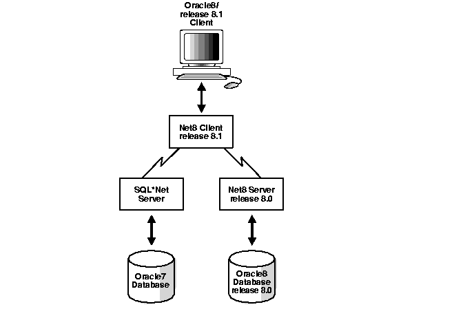

Consider the following client-to-database connection issues before you decide if migrating or upgrading is appropriate for your environment:
As Figure F-1 depicts, an Oracle release 8.1 client requires Net8 Client release 8.1, and an Oracle release 8.1 database requires Net8 Server release 8.1:
The client must be configured with a service name. Configuring the local naming method is described in Net8 Administrator's Guide.

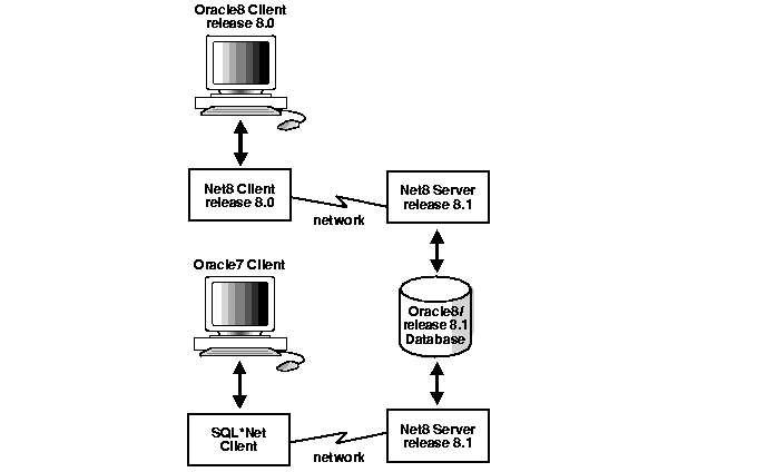

As Figure F-2 depicts, an Oracle release 8.0 client requires a compatible release of Net8 Client, an Oracle7 client requires SQL*Net Client, and an Oracle release 8.1 database requires Net8 Server release 8.1.
New connect descriptors, created for connections to an Oracle release 8.1 database, identify the database by its service name with the SERVICE_NAME parameter. Connect descriptors that are currently configured with the SID parameter, to identify a Oracle release 8.1 database, can remain. To take advantage of new features, such as client load balancing and connect-time failover, Oracle Corporation recommends replacing SID with SERVICE_NAME.
See Also:
Net8 Administrator's Guide for information about database identification by SERVICE_NAME rather than SID. |
A connect descriptor to an Oracle release 8.0 or Oracle7 database uses SID, as shown in the following example:

Consider the following questions for an environment with Oracle release 8.0 or Oracle7 clients connecting to an Oracle release 8.1 database:
No. You must rebuild or upgrade applications to work with Net8 libraries.
No. If a client needs to connect to a remote Oracle release 8.1 database, only SQL*Net Client release 2.x has to be configured on the Oracle7 client and Net8 Client release 8.0 has to be configured on the Oracle release 8.0 client. The only limitation is that the new network features, such as client load balancing and connect-time failover, available with Net8 are unavailable with this connection type.
Yes. If an Oracle7 client needs to connect to a local Oracle release 8.1 database, you must have SQL*Net Client release 2.x, Net8 Client release 8.1, and Net8 Server release 8.1 on the same system. Likewise, an Oracle release 8.0 client requires Net8 Client release 8.0, Net8 Client release 8.1, and Net8 Server release 8.1 on the same system.
Net8 Client and Net8 Server are installed during the installation of Oracle8i Enterprise Edition or Oracle8i.

Consider the following questions for an environment with Oracle release 8.1 clients connecting to an Oracle7 database.
No. If an Oracle release 8.1 client needs to connect to a remote Oracle7 database or Oracle release 8.0 database, only Net8 Client release 8.1 needs to be configured on the client. SQL*Net release 2.x and Net8 Client release 8.0 are upward compatible with Net8. The only limitation is that the new network features available with Net8 release 8.1 are unavailable with this connection type.
Yes. If an Oracle release 8.1 client needs to connect to a local Oracle7 database or Oracle release 8.0 database, you need both SQL*Net Server release 2.x for the Oracle7 database or Net8 Client release 8.0 for the Oracle release 8.0 database on the same system.
