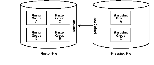

In addition to the different users at the master site, you also need to determine which type of security model you will implement: trusted or untrusted. With a trusted security model, the receiver and proxy snapshot administrator have access to all local master groups. Because the proxy snapshot administrator and receiver perform database activities at the local master site on behalf of the snapshot administrator and propagator, respectively, at the remote snapshot site, the propagator and snapshot administrator also have access to all master groups at the master site. Remember that a single receiver is used for all incoming transactions.
For example, consider the scenario in Figure A-3. Even though Snapshot Groups A and C exist at the snapshot site (based on Master Groups A and C at the Master Site), the propagator and snapshot administrator have access to Master Groups A, B, C, and D at the Master Site because the trusted security model has been used. While this greatly increases the flexibility of database administration, because the DBA can perform administrative functions at any of these remote sites and have these changes propagated to the master sites, it also increases the chances of a malicious user at a remote site viewing or corrupting data at the master site.
Regardless of the security model used, Oracle8i automatically grants the appropriate privileges for objects as they are added to or removed from a replicated environment.

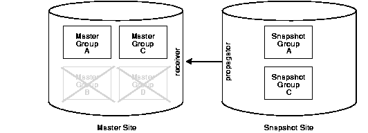

Table A-3 Trusted Security: Snapshot ReplicationUntrusted security assigns only the privileges to the proxy snapshot administrator and receiver that are required to work with specified master groups. The propagator and snapshot administrator, therefore, can only access these specified master groups at the Master Site. Figure A-4 illustrates an untrusted security model with snapshot replication. Because the Snapshot Site contains Snapshot Groups A and C, access to only Master Groups A and C are required. Using untrusted security does not allow the propagator or the snapshot administrator at the Snapshot Site to access Master Groups B and D at the Master Site.
Table A-4 Trusted Security: Snapshot ReplicationTypically, snapshot sites are more vulnerable to security breaches and therefore the untrusted security model is used. There are very few reasons why you would want to use a trusted security model with your snapshot site and it is recommended that you use the untrusted security model with snapshot sites.
