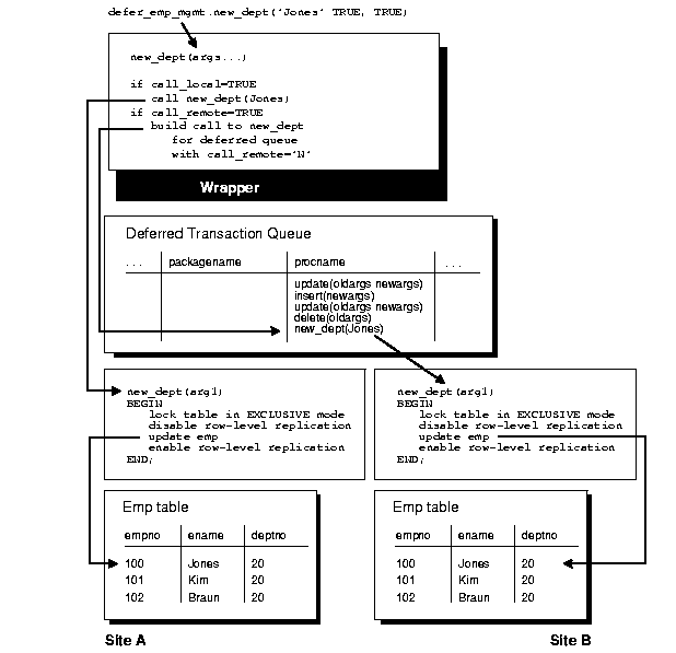

Generating Support for Replicated Procedures
You must disable row-level replication support at the start of your procedure, and then re-enable support at the end. This ensures that any updates that occur as a result of executing the procedure are not propagated to other sites. Row-level replication is enabled and disabled by calling the following procedures, respectively:
When you generate replication support for your replicated package, Oracle creates a wrapper package in the schema of the replication propagator.
Unregistering the current propagator drops all existing generated wrappers in the propagator's schema. Replication support for wrapped stored procedures must be regenerated after you register a new propagator.
The wrapper package has the same name as the original package, but its name is prefixed with the string you supply when you generate replication support for the procedure. If you do not supply a prefix, Oracle uses the default prefix, "defer_". The wrapper procedure has the same parameters as the original, along with two additional parameters: CALL_LOCAL and CALL_REMOTE. These two boolean parameters determine where the procedure gets executed. When CALL_LOCAL is TRUE, the procedure is executed locally. When CALL_REMOTE is TRUE, the procedure will ultimately be executed at all other master sites in the replicated environment.
The remote procedures are called directly if you are propagating changes synchronously. Or calls to these procedures are added to the deferred transaction queue if you are propagating changes asynchronously. By default, CALL_LOCAL is FALSE, and CALL_REMOTE is TRUE.
Oracle generates replication support for a package in two phases. The first phase creates the package specification at all sites. Phase two generates the package body at all sites. These two phases are necessary to support synchronous replication.
For example, suppose you create the package EMP_MGMT containing the procedure NEW_DEPT, which takes one argument, ENAME. To replicate this package to all master sites in your system, you can use Replication Manager to add the package to a master group and then generate replication support for the object. See the Replication Manager online help for more information about managing master groups and replicated objects using Replication Manager. After completing these steps, an application can call procedure in the replicated package as follows:
defer_emp_mgmt.new_dept( ename         => 'Jones',
                        call_local    => TRUE,
                        call_remote  => TRUE);
As shown in Figure 6-1, the logic of the wrapper procedure ensures that the procedure is called at the local site and subsequently at all remote sites. The logic of the wrapper procedure also ensures that when the replicated procedure is called at the remote sites, CALL_REMOTE is FALSE, ensuring that the procedure is not further propagated.
If you are operating in a mixed replicated environment with static partitioning of data ownership (that is, if you are not preventing row-level replication), the replication facility preserves the order of operations at the remote node, because both row-level and procedural replication use the same asynchronous queue.
Figure 6-1 Asynchronous Procedural Replication

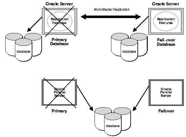

Survivability provides the capability to continue running applications despite system or site failures. Survivability allows you to run applications on a fail over system, accessing the same, or very nearly the same, data as these systems accessed on the primary system when it failed. As shown in Figure 6-2, the Oracle server provides two different technologies for accomplishing survivability: the Oracle Parallel Server and the replication facility.
Figure 6-2 Survivability Methods: Replication vs. Parallel Server
Oracle Parallel Server versus Replication
The Oracle Parallel Server supports fail over to surviving systems when a system supporting an instance of the Oracle Server fails. The Oracle Parallel Server requires a cluster or massively parallel hardware platform, and thus is applicable for protection against processor system failures in the local environment where the cluster or massively parallel system is running.
In these environments, the Oracle Parallel Server is the ideal solution for survivability -- supporting high transaction volumes with no lost transactions or data inconsistencies in the event of an instance failure. If an instance fails, a surviving instance of the Oracle Parallel Server automatically recovers any incomplete transactions. Applications running on the failed system can execute on the fail over system, accessing all data in the database.
The Oracle Parallel Server does not, however, provide survivability for site failures (such as flood, fire, or sabotage) that render an entire site, and thus the entire cluster or massively parallel system, inoperable. To provide survivability for site failures, you can use the replication facility to maintain a replica of a database at a geographically remote location.
Should the local system fail, the application can continue to execute at the remote site. Replication, however, cannot guarantee the protection of all transactions. Also, special care must be taken to prevent data inconsistencies when recovering the primary site.
You can also configure a standby-database to protect an Oracle database from site failures. For more information about Oracle's standby database feature, see the Oracle8i Backup and Recovery Guide.

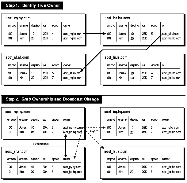

For example, Figure 6-3 illustrates how ownership of employee 100 passes from the ACCT_SF database to the ACCT_NY database.
Figure 6-3 Grabbing the Token
Locating the Owner of a Row
To obtain ownership, the ACCT_NY database uses a simple recursive algorithm to locate the owner of the row. The pseudo code for this algorithm is shown below:
-- Pseudo code for locating the token owner.
-- This is for a table TABLE_NAME with primary key PK.
-- Initial call should initialize loc_epoch to 0 and loc_owner
-- to the local global name.
get_owner(PK IN primary_key_type, loc_epoch IN OUT NUMBER,
          loc_owner IN OUT VARCHAR2)
  -- use dynamic SQL (dbms_sql) to perform a select similar to
  -- the following:
  SELECT owner, epoch into rmt_owner, rmt_epoch
     FROM TABLE_NAME@loc_owner
     WHERE primary_key = PK FOR UPDATE;
  IF rmt_owner = loc_owner AND rmt_epoch >= loc_epoch THEN
   loc_owner := rmt_owner;
   loc_epoch := rmt_epoch;
   RETURN;
  ELSIF rmt_epoch >= loc_epoch THEN
   get_owner(PK, rmt_epoch, rmt_owner);
   RETURN;
  ELSE
   raise_application_error(-20000, 'No owner for row');
  END IF;
Obtaining Ownership
After locating the owner of the row, the ACCT_NY site gets ownership from the ACCT_SF site by completing the following steps:
  1. Lock the row at the SF site to prevent any changes from occurring while ownership is being exchanged.
  2. Synchronously update the owner information at both the SF and NY sites. This ensures that only one site considers itself to be the owner at all times. The update at the SF site should not be replicated using DBMS_REPUTIL.REPLICATION_OFF. The replicated change of ownership at the NY site in Step 4 will ultimately be propagated to all other sites in the replicated environment, including the SF site, where it will have no effect.
  3. Update the row information at the new owner site, NY, with the information from the current owner site, SF. This data is guaranteed to be the most recent. This time, the change at the NY site should not be replicated. Any queued changes to this data at the SF site are propagated to all other sites in the usual manner. When the SF change is propagated to NY, it is ignored because of the values of the epoch numbers, as described in the next bullet point.
  4. Update the epoch number at the new owner site to be one greater than the value at the previous site. Perform this update at the new owner only, and then asynchronously propagate this update to the other master sites. Incrementing the epoch number at the new owner site prevents ordering conflicts.
    When the SF changes (that were in the deferred queue in Step 2 above) are ultimately propagated to the NY site, the NY site ignores them because they have a lower epoch number than the epoch number at the NY site for the same data.
    As another example, suppose the HQ site received the SF changes after receiving the NY changes, the HQ site would ignore the SF changes because the changes applied from the NY site would have the greater epoch number.
Applying the Change
You should design your application to implement this method of token passing for you automatically whenever you perform an update. You should not allow the owner or epoch columns to be updated outside this application. The lock that you grab when you change ownership is released when you apply your actual update. The changed information, along with the updated owner and epoch information, are asynchronously propagated to the other sites in the usual manner.
