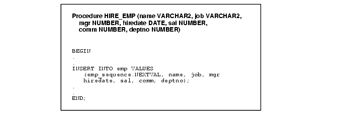

Figure 17-1 illustrates a simple procedure that is stored in the database and called by several different database applications.
Procedures and functions are identical except that functions always return a single value to the caller, while procedures do not. For simplicity, procedure as used in the remainder of this chapter means procedure or function.
The stored procedure in Figure 17-1, which inserts an employee record into the EMP table, is shown in Figure 17-2.
All of the database applications in Figure 17-1 call the HIRE_EMP procedure. Alternatively, a privileged user might use Oracle Enterprise Manager or SQL*Plus to execute the HIRE_EMP procedure using the following statement:
EXECUTE hire_emp ('TSMITH', 'CLERK', 1037, SYSDATE, \ 500, NULL, 20);
This statement places a new employee record for TSMITH in the EMP table.
