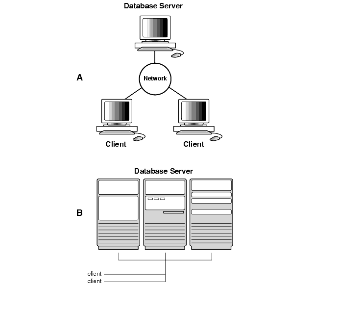

In the Oracle database system environment, the database application and the database are separated into two parts: a front-end or client portion, and a back-end or server portion--hence the term client/server architecture. The client executes the database application that accesses database information and interacts with a user through the keyboard, screen, and pointing device such as a mouse. The server executes the Oracle software and handles the functions required for concurrent, shared data access to an Oracle database.
Although the client application and Oracle can be executed on the same computer, greater efficiency can often be achieved when the client portion(s) and server portion are executed by different computers connected via a network. The following sections discuss possible variations in the Oracle client/server architecture.
Distributed processing is the use of more than one processor to perform the processing for an individual task. Examples of distributed processing in Oracle database systems appear in Figure 6-1.

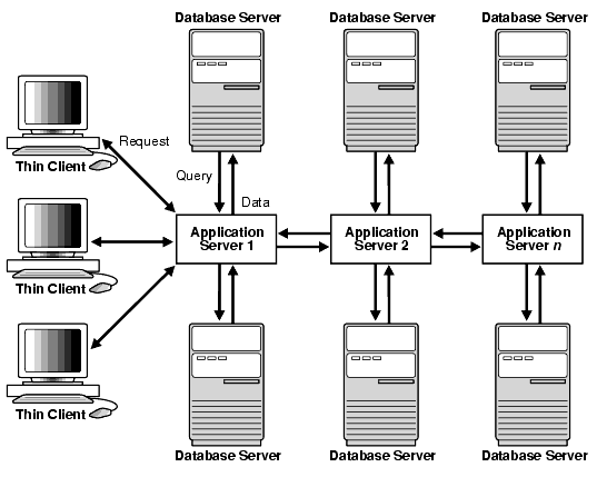

In a multi-tier architecture environment, an application server provides data for clients and serves as an interface between clients and database servers.
This architecture allows you to use an application server to:
An example of a multi-tier architecture appears in Figure 6-2.
A client initiates a request for an operation to be performed on the database server. The client can be a web browser or other end-user process. In a multi-tier architecture, the client connects to the database server through one or more application servers.
An application server provides access to the data for the client. It serves as an interface between the client and one or more database servers, which provides an additional level of security. It can also perform some of the query processing for the client, thus removing some of the load from the database server.
The application server assumes the identity of the client when it is performing operations on the database server for that client. The application server's privileges are restricted to prevent it from performing unneeded and unwanted operations during a client operation.
A database server provides the data requested by an application server on behalf of a client. The database server does all of the remaining query processing.
The Oracle database server can audit operations performed by the application server on behalf of individual clients as well as operations performed by the application server on its own behalf. For example, a client operation might be a request for information to be displayed on the client whereas an application server operation might be a request for a connection to the database server.
