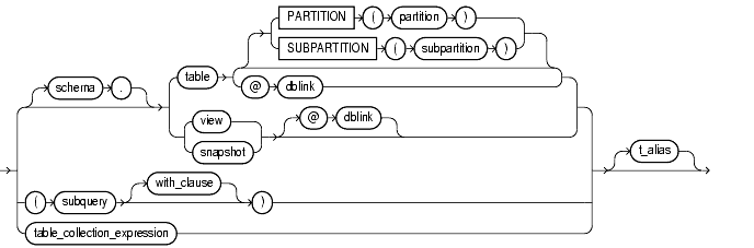

DML_table_expression_clause::=
subquery: see "SELECT and Subqueries".

You can place a parallel hint immediately after the See Also:
DML_table_expression_clause |
schema |
is the schema containing the table or view. If you omit schema, Oracle assumes the table or view is in your own schema. |
table | view | subquery |
is the name of the table or view, or the columns returned by a subquery, to be updated. Issuing an If table (or the base table of view) contains one or more domain index columns, this statement executes the appropriate indextype update routine. See Also: Oracle8i Data Cartridge Developer's Guide for more information on these routines. |

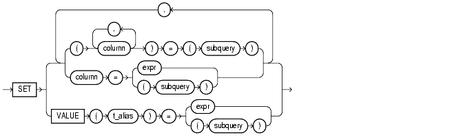

set_clause |
column |
is the name of a column of the table or view that is to be updated. If you omit a column of the table from the set_clause, that column's value remains unchanged. Restrictions:
subquery |
is a subquery that returns exactly one row for each row updated.
If the subquery returns no rows, then the column is assigned a null. See Also: "SELECT and Subqueries" and "Using Subqueries". |
Note: If this subquery refers to remote objects, the |
expr |
is the new value assigned to the corresponding column. This expression can contain host variables and optional indicator variables. See Also: The syntax description in "Expressions". |
lets you specify the entire row of an object table. Restriction: You can specify this clause only for an object table. See Also: "SET VALUE Example". |
