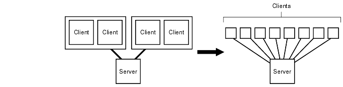

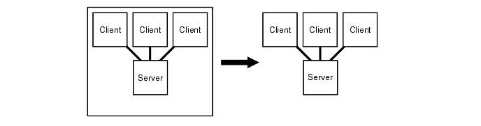

Consider whether changing from several clients with one server, all running on a single machine (single tier), to a two-tier client/server configuration would relieve CPU problems.
Consider whether using smaller clients improves CPU usage rather than using multiple clients on larger machines. This strategy may be helpful with either two-tier or three-tier configurations.

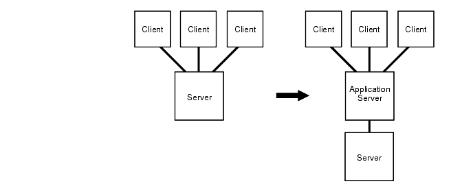

If your system runs with multiple layers, then consider whether moving from a two-tier to three-tier configuration and introducing an application server or a transaction processing monitor might be a good solution.

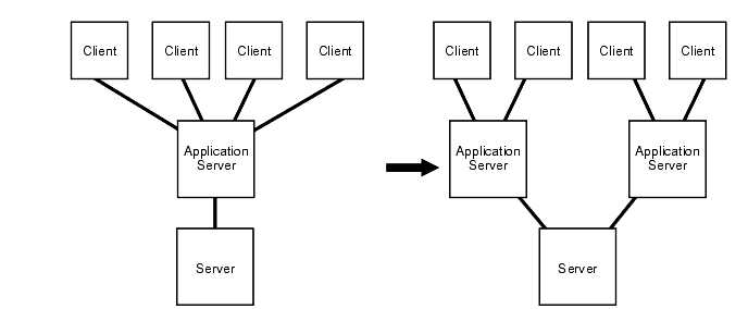

Consider using one or more application servers or multiple transaction processing monitors.

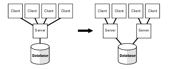

Consider whether incorporating Oracle Parallel Server would solve your CPU problems.
