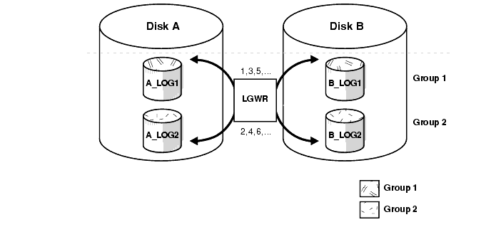

Oracle provides the capability to multiplex an instance's online redo log files to safeguard against damage. When multiplexing online redo log files, LGWR concurrently writes the same information to multiple identical online redo log files, thereby eliminating a single point of failure. You can also mirror redo logs at the operating system level, but in so doing you run the risk of operating system or hardware induced corruption. In most cases, multiplexing of online logs is best.
Oracle recommends multiplexing the online redo log on separate physical disks or possibly different file systems. If the file systems or disk subsystems support mirroring, this operation adds another level of redundancy. The online redo log is the source of your recovery data. Loss of all copies of an online log can mean the loss of committed transaction data.
The corresponding online redo log files are called groups. Each online redo log file in a group is called a member. In Figure 2-2, files A_LOG1
and B_LOG1
are both members of Group 1; A_LOG2
and B_LOG2
are both members of Group 2, and so forth. Each member in a group must be the exact same size.
Notice that each member of a group is concurrently active, that is, concurrently written to by LGWR, as indicated by the identical log sequence numbers assigned by LGWR. In Figure 2-2, first LGWR writes to file A_LOG1
in conjunction with B_LOG1
, then A_LOG2
in conjunction with B_LOG2
, etc. LGWR never writes concurrently to members of different groups, for example, to A_LOG1
and B_LOG2
Whenever LGWR cannot write to a member of a group, Oracle marks this member as stale and writes an error message to the LGWR trace file and to the database's alert log to indicate the problem with the inaccessible files. LGWR reacts differently when certain online redo log members are unavailable, depending on the reason for the unavailability.

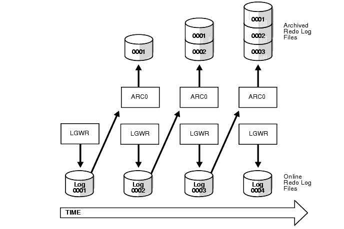

When you run a database in ARCHIVELOG mode, Oracle requires the online redo log to be archived. You can either perform the archiving manually or enable automatic archiving.
In ARCHIVELOG mode, the database control file indicates that a group of filled online redo log files cannot be used by LGWR until the group is archived. A filled group is immediately available to ARCn after a log switch occurs. After the group has been successfully archived, Oracle can reuse the group.
Figure 2-3 illustrates the basic principle of archiving. LGWR writes to a log and then ARCn archives it. Each new write is assigned a new log sequence number, so the log sequence numbers increment by 1.
The archiving of filled groups has these advantages:
