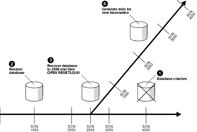

  4. Mimic incomplete database recovery by issuing the following statement:
    ALTER DATABASE RECOVER DATABASE UNTIL CANCEL;
  5. Open the database and reset the current redo log sequence to 1:
    ALTER DATABASE OPEN RESETLOGS;
    A RESETLOGS operation invalidates all redo in the online logs. Restoring from a whole database backup and then resetting the log discards all changes to the database made from the time the backup was taken to the time of the failure.

  7. Mimic incomplete database recovery by issuing the following statement:
  8. Mimic incomplete database recovery by issuing the following statement:
    ALTER DATABASE RECOVER CANCEL;
  9. Open the database and reset the current redo log sequence to 1:

What Is a RESETLOGS Operation?
Whenever you open the database with the RESETLOGS option, all datafiles get a new RESETLOGS SCN and timestamp. Archived redo logs also have these two values in their header. Because Oracle will not apply an archived redo log to a datafile unless the RESETLOGS SCN and timestamps match, the RESETLOGS operations prevents you from corrupting your datafiles with old archived logs.
Figure 5-1 shows the case of a database that can only be recovered to SCN 2500 because an archived redo log is missing. At SCN 4000, the database crashes. You restore the SCN 1000 backup and prepare for complete recovery. Unfortunately, one of your archived redo logs is corrupted. The log before the missing log contains SCN 2500, so you recover to this point and open with the RESETLOGS option.
As the diagram illustrates, you generate new changes in the new incarnation of the database, eventually reaching SCN 4000. The changes between SCN 2500 and SCN 4000 for the new incarnation of the database are completely different from the changes between SCN 2500 and SCN 4000 for the old incarnation. Oracle does not allow you to apply logs from an old incarnation to the new incarnation. You cannot restore backups from before SCN 2500 in the old incarnation to the new incarnation.
Figure 5-1 Creating a New Database Incarnation

If you open with the RESETLOGS option, Oracle returns different messages depending on whether recovery was complete or incomplete. If the recovery was complete, the following message appears in the alert.log file:
RESETLOGS after complete recovery through change scn
If the recovery was incomplete, this message is reported in the ALERT file:
RESETLOGS after incomplete recovery UNTIL CHANGE scn
If you attempt to reset the log when you should not, or if you neglect to reset the log when you should, Oracle returns an error and does not open the database. Correct the error and try again.
Following Up After a RESETLOGS Operation
