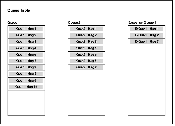

The preceding figure portrays a queue table that contains two queues, and one exception queue:

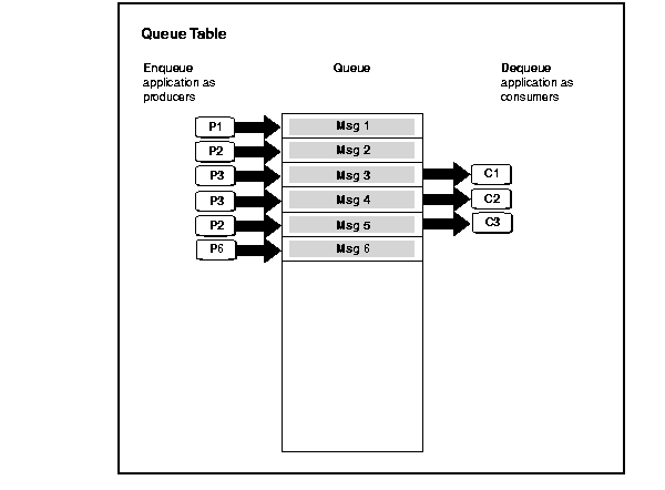

Figure 7-2, "Modeling Basic Queuing" (below) portrays a queue table that contains one queue into which messages are being enqueued and from which messages are being dequeued.
The figure indicates that there are 6 producers of messages, although only four are shown. This assumes that two other producers (P4 and P5) have the right to enqueue messages even though there are no messages enqueued by them at the moment portrayed by the figure. The figure shows:
According to the figure, there are 3 consumers of messages, representing the total population of consumers. The figure shows:

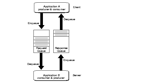

Client-Server applications normally execute in a synchronous manner, with all the disadvantages of that tight coupling described above. Figure 7-3, "Client-Server Communication Using AQ" demonstrates the asynchronous alternative using AQ. In this example Application B (a server) provides service to Application A (a client) using a request/response queue.
In this way the client does not have to wait to establish a connection with the server, and the server dequeues the message at its own pace. When the server is finished processing the message, there is no need for the client to be waiting to receive the result. In this way a process of double-deferral frees both client and server.

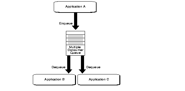

Figure 7-5 illustrates the same technology from a dynamic perspective. This examples concerns a scenario in which more than one application needs the result produced by an application. Every message enqueued by Application A is dequeued by Application B and Application C. To make this possible, the multiple consumer queue is specially configured with Application B and Application C as queue subscribers. Consequently, they are implicit recipients of every message placed in the queue.

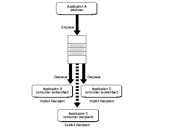

We earlier referred to subscribers as "implicit recipients" in that they are able to dequeue all the messages placed into a specific queue. This is like subscribing to a magazine and thereby implicitly gaining access to all its articles. The category of consumers that we have referred to as recipients may also be viewed as "explicit recipients" in that they are designated targets of particular messages.
Figure 7-7 shows how Oracle AQ can adjust dynamically to accommodate both kinds of consumers. In this scenario Application B and Application C are implicit recipients (subscribers). But messages can also be explicitly directed toward specific consumers (recipients) who may or may not be subscribers to the queue. The list of such recipients is specified in the enqueue call for that message and overrides the list of subscribers for that queue. In the figure, Application D is specified as the sole recipient of a message enqueued by Application A.

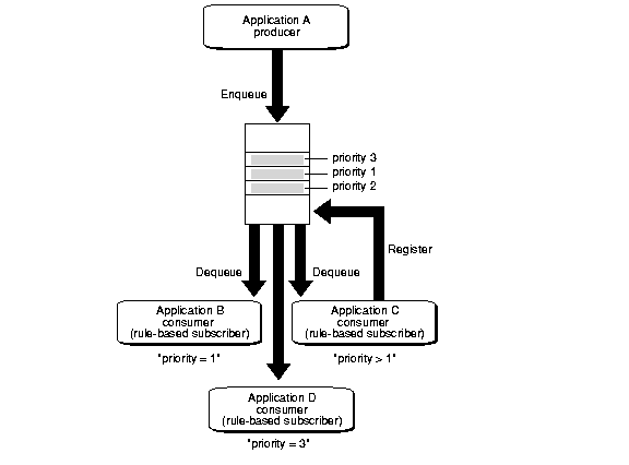

Figure 7-9 illustrates the use of AQ for implementing a publish/subscribe messaging scheme between applications. Application A is a publisher application which is publishing messages to a queue. Applications B, C, D are subscriber applications. Application A publishes messages anonymously to a queue. These messages are then delivered to subscriber applications based on the rules specified by each application. Subscriber applications can specify interest in messages by defining a rule on message properties and message data content.
In the example shown, applications B has subscribed with rule "priority=1", application C has subscribed with rule "priority > 1" and application D has subscribed with rule "priority = 3". Application A enqueues 3 messages (priority 3, 1, 2). Application B receives a single message (priority 1), application C receives two messages (priority 2, 3) and application D receives a single message (priority 3). Thus, message recipients are computed dynamically based on message properties and content. Additionally, the figure also illustrates how application C uses asynchronous notification for message delivery. Application C registers for messages on the queue. When messages arrive, application C is notified and can then dequeue the messages.

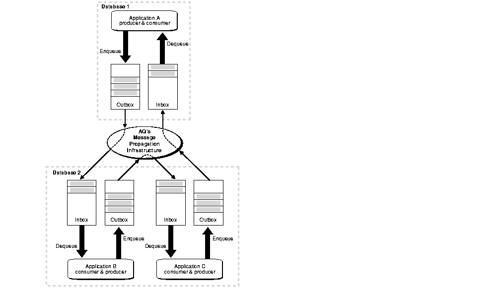

Figure 7-10 illustrates applications on different databases communicating via AQ. Each application has an inbox and an outbox for handling incoming and outgoing messages. An application enqueues a message into its outbox irrespective of whether the message has to be sent to an application that is local (on the same node) or remote (on a different node).
Likewise, an application is not concerned as to whether a message originates locally or remotely. In all cases, an application dequeues messages from its inbox.
Oracle AQ facilitates all this interchange, treating messages on the same basis.
