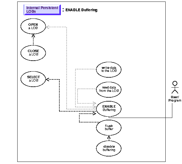

This procedure describes how to enable LOB buffering.
Enable buffering when performing a small read or write of data. Once you have completed these tasks, you must disable buffering before you can continue with any other LOB operations.
For more information, refer to "LOB Buffering Subsystem" in Chapter 5, "Advanced Topics".
See Chapter 3, "LOB Programmatic Environments" for a list of available functions in each programmatic environment. Use the following syntax references for each programmatic environment:
This scenario is part of the management of a buffering example related to Sound that is developed in this and related methods.
Examples are provided in the following programmatic environments:
