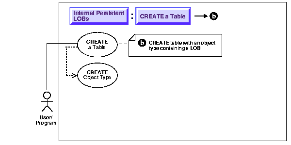

This procedure describes how to create a table containing an object type with an LOB attribute.
Not applicable.
See the following specific reference for a detailed syntax description:
As shown in the diagram, you must create the object type that contains LOB attributes before you can proceed to create a table that makes use of that object type.
