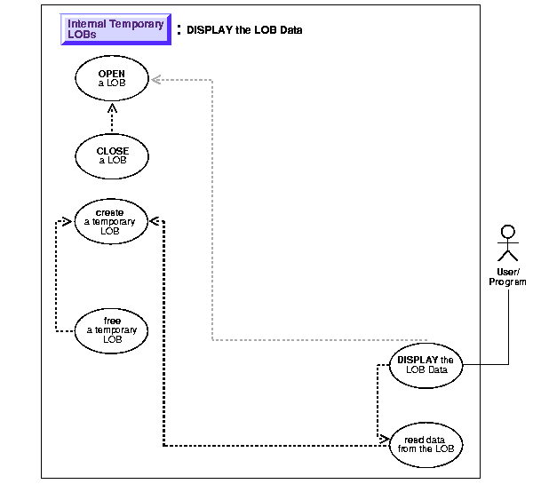

See:
"Use Case Model: Internal Temporary LOBs", for all basic operations of Internal Temporary LOBs. |
This procedure describes how to display temporary LOB data.
Not applicable.
See Chapter 3, "LOB Programmatic Environments" for a list of available functions in each programmatic environment. Use the following syntax references for each programmatic environment:
As an instance of displaying a LOB, our example stream-reads the image Drawing from the column object Map_obj onto the client-side in order to view the data.
Examples are provided in the following programmatic environments:
