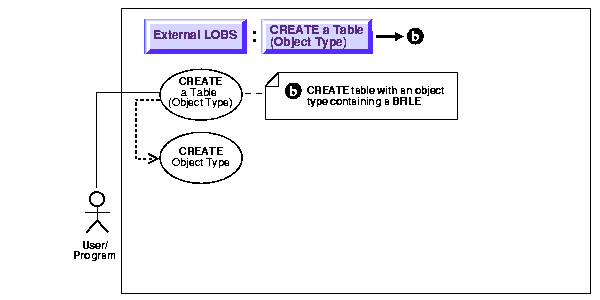

This procedure describes how to create a table of an object type with a BFILE attribute.
As shown in the diagram, you must create the object type that contains the BFILE attributes before you can proceed to create a table that makes use of that object type.
