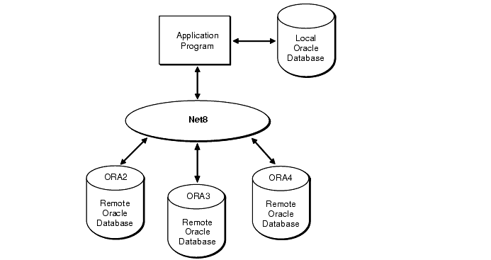

The communicating points in a network are called nodes. Net8 lets you transmit information (SQL statements, data, and status codes) over the network from one node to another.
A protocol is a set of rules for accessing a network. The rules establish such things as procedures for recovering after a failure and formats for transmitting data and checking errors.
The Net8 syntax for connecting to the default database in the local domain is simply to use the service name for the database.
If the service name is not in the default (local) domain, you must use a global specification (all domains specified). For example:
HR.US.ORACLE.COM
Pro*C/C++ supports distributed processing via Net8. Your application can concurrently access any combination of local and remote databases or make multiple connections to the same database. In Figure 3-1, an application program communicates with one local and three remote Oracle8 databases. ORA2, ORA3, and ORA4 are simply logical names used in CONNECT statements.
By eliminating the boundaries in a network between different machines and operating systems, Net8 provides a distributed processing environment for Oracle8 tools. This section shows you how Pro*C/C++ supports distributed processing via Net8. You learn how your application can
For details on installing Net8 and identifying available databases, refer to the Net8 Administrator's Guide and your system-specific Oracle8 documentation.
Each node has a default database. If you specify a database name, but no domain, in your CONNECT statement, you connect to the default database on the named local or remote node.
A default connection is made by a CONNECT statement that has no AT clause. The connection can be to any default or non-default database at any local or remote node. SQL statements without an AT clause are executed against the default connection. Conversely, a non-default connection is made by a CONNECT statement that has an AT clause. SQL statements with an AT clause are executed against the non-default connection.

A distributed database is a single logical database comprising multiple physical databases at different nodes. A distributed statement is any SQL statement that accesses a remote node using a database link. A distributed transaction includes at least one distributed statement that updates data at multiple nodes of a distributed database. If the update affects only one node, the transaction is non-distributed.
When you issue a COMMIT, changes to each database affected by the distributed transaction are made permanent. If instead you issue a ROLLBACK, all the changes are undone. However, if a network or machine fails during the commit or rollback, the state of the distributed transaction might be unknown or in doubt. In such cases, if you have FORCE TRANSACTION system privileges, you can manually commit or roll back the transaction at your local database by using the FORCE clause. The transaction must be identified by a quoted literal containing the transaction ID, which can be found in the data dictionary view DBA_2PC_PENDING. Some examples follow:
