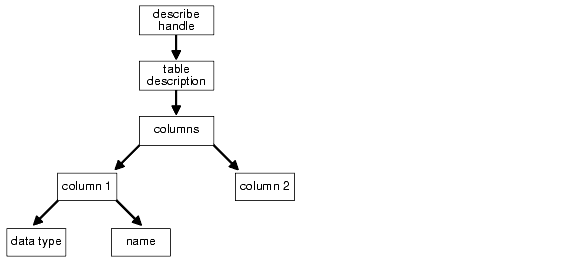

The information returned by OCIDescribeAny() is organized hierarchically like a tree. For example, Figure 6-1 shows how the description of a certain table might be organized.
Figure 6-1 OCIDescribeAny() Table Description
The describe handle returned by OCIDescribeAny() has an attribute, OCI_ATTR_PARAM, that points to such a description tree. Each node of the tree has attributes associated with the node and attributes (which are like recursive describe handles) that point to subtrees containing more information. If all the attributes are homogenous, as in case of elements of a list, such as a column list, then we refer to them as parameters. In this chapter, the terms handle and parameter are used interchangeably. The attributes associated with any node are returned by OCIAttrGet(), and the parameters are returned by OCIParamGet().
For example, an OCIAttrGet() on the describe handle for the table can return a handle to the column-list information. An application can then use OCIParamGet() to retrieve the handle to the column description of a particular column in the column-list. The handle to the column descriptor can be passed to OCIAttrGet() to get further information about the column, such as the name and data type (as illustrated by following the left-hand side of the above figure).
No subsequent OCIAttrGet() or OCIParamGet() call requires extra round trips, as all the description is cached on the client side by OCIDescribeAny().

Retrieving Column Data Types For a Table
This example illustrates the use of an explicit describe. Let us take an example application, which needs to retrieve the column datatypes for a table. The following code fragment shows how an application would be able to use the describe interface:
text objptr[] = <table-name>;
ub4 objp_len = strlen(<table_name>);
OCIParam *parmh;         /* parameter handle */
OCIParam *collsthd;      /* handle to list of columns */
OCIParam *colhd;         /* column handle */
OCIDescribe *dschp;      /* describe handle */
/* get the describe handle for the table */
if (OCIDescribeAny(svch, errh, objptr, objp_len, OCI_OTYPE_NAME, 0,
     OCI_PTYPE_TABLE, dschp))
   return error;
/* get the parameter handle */
if (OCIAttrGet(dschp, OCI_HTYPE_DESCRIBE, &parmh, 0, OCI_ATTR_PARAM,
     errh))
    return error;
/* The type information of the object, in this case, OCI_PTYPE_TABLE,
is obtained from the parameter descriptor returned by the OCIAttrGet(). */
/* get the number of columns in the table */
if (OCIAttrGet(parmh, OCI_DTYPE_PARAM, &numcols, 0,
     OCI_ATTR_NUM_COLS, errh))
    return error;
/* get the handle to the column list of the table */
if (OCIAttrGet(parmh, OCI_DTYPE_PARAM, &collsthd, 0,
     OCI_ATTR_LIST_COLUMNS, errh)==OCI_NO_DATA)
   return error;
/* go through the column list and retrieve the data-type of each column,
and then recursively describe column types. */
for (i = 1; i <= numcols; i++)
    /* get parameter for column i */
    if (OCIParamGet(collsthd, OCI_DTYPE_PARAM, errh, &colhd, i))
        return error;
    /* for example, get data type for ith column */
    if (OCIAttrGet(colhd, OCI_DTYPE_PARAM, &datatype[i-1], 0,
       OCI_ATTR_DATA_TYPE, errh))
        return error;
