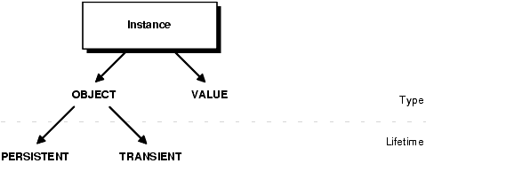

An object instance is an occurrence of a type defined in an Oracle database. This section describes how an object instance can be represented in OCI. See Figure 16-1. In OCI, an object instance can be classified based on the type, the lifetime and referenceability:
A value can be standalone or embedded. A standalone value is usually obtained by issuing a select statement. OCI also allows the client program to select a row of object table into a value by issuing a SQL statement. A referenceable object in the database can be represented as a value which cannot be identified by a reference. A standalone value can also be an out-of-line attribute in an object, such as VARCHAR or raw, or an out-of-line element in a collection, such as VARCHAR, raw, or object.
An embedded value is physically included in a containing instance. An embedded value can be an in-line attribute in an object. such as number or nested object, or an in-line element in a collection.
All values are considered to be transient by OCI, which means that OCI does not support automatic flushing a value to the database, and the client has to explicitly execute a SQL statement to store a value into the database. For embedded values, they are flushed when their containing instance are flushed.
Figure 16-1 shows how instances can be classified according to their type and lifetime:
The distinction between various instances is further illustrated by the following table:
In the remainder of this chapter, the following terms will be used:
For a further discussion of the terms used to refer to different types of objects, please see "Persistent Objects, Transient Objects, and Values".
