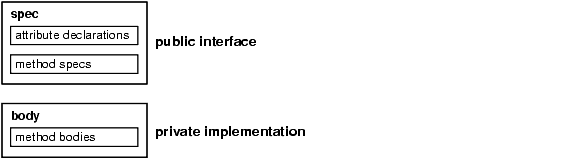

Like a package, an object type has two parts: a specification and a body (refer to Figure 9-3). The specification (spec for short) is the interface to your applications; it declares a data structure (set of attributes) along with the operations (methods) needed to manipulate the data. The body fully defines the methods, and so implements the spec.
All the information a client program needs to use the methods is in the spec. Think of the spec as an operational interface and of the body as a black box. You can debug, enhance, or replace the body without changing the spec--and without affecting client programs.
In an object type spec, all attributes must be declared before any methods. Only subprograms have an underlying implementation. So, if an object type spec declares only attributes, the object type body is unnecessary. You cannot declare attributes in the body. All declarations in the object type spec are public (visible outside the object type).
To understand the structure better, study the example below, in which an object type for complex numbers is defined. For now, it is enough to know that a complex number has two parts, a real part and an imaginary part, and that several arithmetic operations are defined for complex numbers.
CREATE TYPE Complex AS OBJECT ( rpart REAL, -- attribute ipart REAL, MEMBER FUNCTION plus (x Complex) RETURN Complex, -- method MEMBER FUNCTION less (x Complex) RETURN Complex, MEMBER FUNCTION times (x Complex) RETURN Complex, MEMBER FUNCTION divby (x Complex) RETURN Complex ); CREATE TYPE BODY Complex AS MEMBER FUNCTION plus (x Complex) RETURN Complex IS BEGIN RETURN Complex(rpart + x.rpart, ipart + x.ipart); END plus; MEMBER FUNCTION less (x Complex) RETURN Complex IS BEGIN RETURN Complex(rpart - x.rpart, ipart - x.ipart); END less; MEMBER FUNCTION times (x Complex) RETURN Complex IS BEGIN RETURN Complex(rpart * x.rpart - ipart * x.ipart, rpart * x.ipart + ipart * x.rpart); END times; MEMBER FUNCTION divby (x Complex) RETURN Complex IS z REAL := x.rpart**2 + x.ipart**2; BEGIN RETURN Complex((rpart * x.rpart + ipart * x.ipart) / z, (ipart * x.rpart - rpart * x.ipart) / z); END divby; END;
