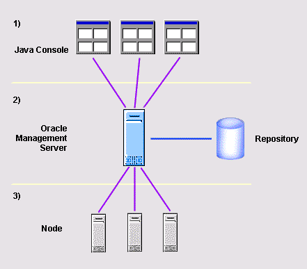

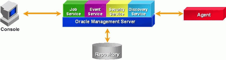

Oracle Enterprise Manager's Architecture
Oracle Enterprise Manager has a three-tiered architecture. The first tier, the client, consists of a Java-based Console and integrated applications. The second tier is the Management Server or designated group of Management Servers which provides centralized intelligence and distributed control between clients and targets. The third tier is comprised of targets, such as databases, nodes, or other managed services. An Intelligent Agent resides on each target and monitors the services in the target for registered events (potential problem occurrences) and executes jobs sent by the Console via the Oracle Management Server(s).
Only one agent can exist per machine, regardless of the number of services on that machine.
Oracle Enterprise Manager's three main components are listed below:
Component  Function
Console
The Console gives you a central point of control for the Oracle environment through an intuitive graphical user interface (GUI) that provides powerful and robust system management.
Management Server
The Oracle Management Server provides centralized intelligence and distributed control between the Console and the managed nodes. It processes system management tasks sent by the Console and administers the distribution of these tasks across the enterprise. The Oracle Management Server stores all system data, application data, and information about the state of managed nodes in a repository, which is a set of tables stored in a database. The Management Server in charge of a job or event stores all the information about the status of the job or event (whether it is scheduled, waiting for a response from the Intelligent Agent, waiting to notify the Console, and so on.) High performance and scalability is ensured because the workload is automatically shared and balanced when there are multiple Management Servers.
Intelligent Agent
The Intelligent Agent is a process that runs on managed nodes in the network. It functions as the executor of jobs and events sent by the Console via the Management Servers.
