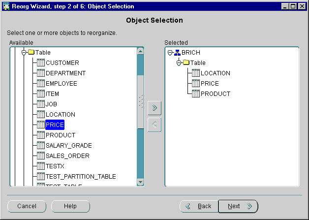

The Reorg Wizard interface varies depending on how the wizard is launched. When launched in context to a selected database object, the wizard displays screens that are appropriate for that object. You can get specific information for any of the pages from the Reorg Wizard's online help. See Figure 22-1 for a sample Reorg Wizard page.
The Reorg Wizard leads you through the process of reorganizing objects within a database. As part of the process you will be able to select the objects targeted for reorganization, optionally change the storage setting and location of these selected objects, and then perform the reorganization immediately or schedule it to be performed at later time.

The reorganization option allows you to chose the type of reorganization to perform. There are two reorganization options: reorganize specific schema objects or reorganize an entire tablespace.
A list of available objects is displayed. The wizard allows you to select the objects you wish to reorganize.
When reorganizing schema objects, it is possible to change the object location and sizing information for the individual selected objects not only to correct existing space usage problems, but also to prevent future problems.
