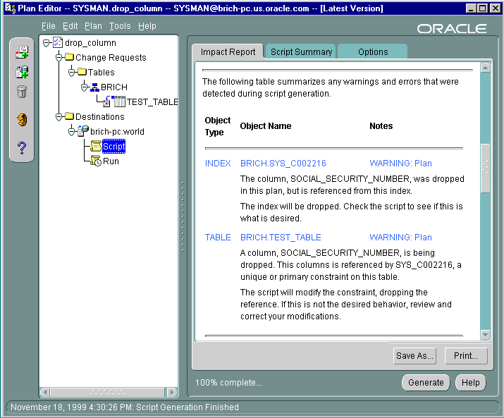

Figure 3-5 shows a fully expanded change plan in Plan Editor with the Script subobject selected.
Oracle Change Management Pack creates an impact report when it generates the script. You should view the impact report to determine the impact of executing the script at the destination database. The impact report provides a summary of the number and types of objects that will be modified when the script executes at the destination database. The impact report also shows warnings and errors, including a description of the requested operations that cannot be performed at the destination database, for example, a request to drop a column that no longer exists at the destination database.
After generating the script, you should view the impact report and script summary. You can also edit the script.
Script errors must be fixed. Evaluate the errors, take corrective action, then regenerate the script.
Script warnings should be read and the appropriate action taken before you attempt to execute the script. Some warnings are informational, for example, a message that dropping a column will cause an index to be dropped, as shown in Figure 3-5. To save the impact report to a file, click the Save As button.
