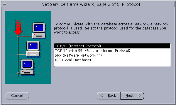

A database service may be accessed by more than one network route, or listener address. In the following example, sales.us.acme.com can connect to sales.us.acme.com using listeners on either sales1-server or sales2-server.
sales.us.acme.com= (description= (address_list= (address=(protocol=tcp)(host=sales1-server)(port=1521)) (address=(protocol=tcp)(host=sales2-server)(port=1521))) (connect_data= (service_name=sales.us.acme.com)))

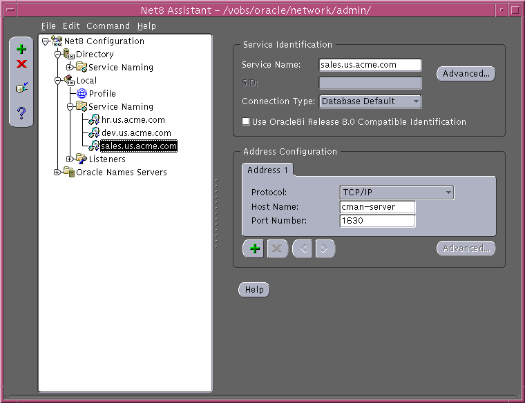

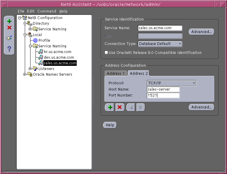

To add a network protocol address to an existing net service name or database service:

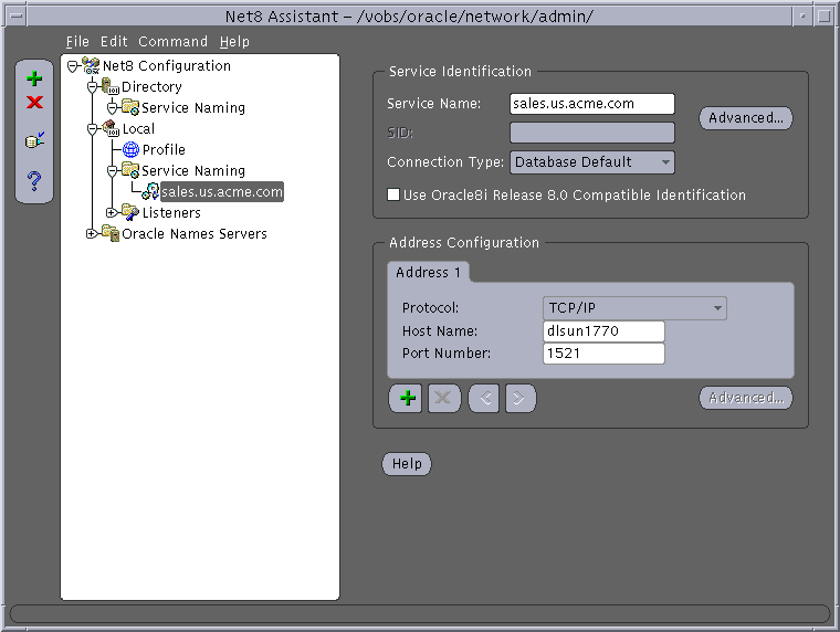

The right pane displays the current destination service and address list.
A new address tab appears:
When a database service is accessible by multiple listener protocol addresses, it is important to specify the order of how the addresses are to be used. For example, the addresses can be chosen randomly or tried sequentially.
When multiple protocol addresses have been configured for a net service name or database service, the following options may be configured:

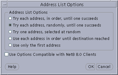

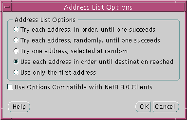

To configure connect-time failover or client load balancing:
The right pane displays the current destination service and address list:
The Address List Options dialog box appears:
The following table describes the options:
In the following example, the tnsnames.ora file is configured for client load balancing with the "Try each address, randomly, until one succeeds" option:
sales.us.acme.com= (description= (address_list= (load_balance=on) (address=(protocol=tcp)(host=sales1-server)(port=1521)) (address=(protocol=tcp)(host=sales2-server)(port=1521))) (connect_data= (service_name=sales.us.acme.com)))
In the following example, the tnsnames.ora file is configured for connect-time failover with the "Try each address, in order, until one succeeds" option:
sales.us.acme.com= (description= (address_list= (load_balance=off) (failover=on) (address=(protocol=tcp)(host=sales1-server)(port=1521)) (address=(protocol=tcp)(host=sales2-server)(port=1521))) (connect_data=(service_name=sales.us.acme.com)))

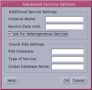

Besides the service name, connect data information may be optionally configured with the following parameters:
| tnsnames.ora File Parameter | Net8 Assistant Field/Option | Description |
Instance Name |
Identifies the database instance to access The instance name can be obtained from the INSTANCE_NAME parameter in the initialization parameter file. Note: Not enabled if "Use Oracle8i Release 8.0 Compatible Identification" is checked. See Also: "Understanding Connect Descriptors" |

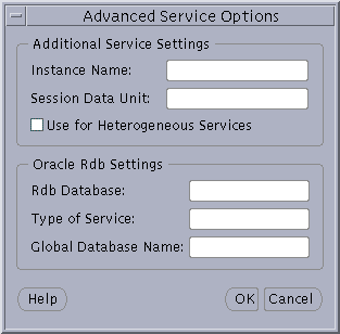

Session Data Unit Size |
If you want to optimize the transfer rate of data packets being sent across the network, you can specify the session data unit (SDU) size to change the performance characteristics having to do with the packets sent across the network. See Also: "Adjusting the Session Data Unit (SDU) Size for Data Transfer Optimization" |
Use for Heterogeneous Services |
If you want an Oracle8i server to access a non-Oracle system, turn this option on. See Also: "Configuring Net8 for Oracle Heterogeneous Services" |

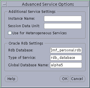

Oracle Rdb Settings |
Oracle RDB Database |
TYPE_OF_SERVICE) |
Type of Service |
Specifies the type of service to use for an Oracle RDB database |
GLOBAL_NAME) |
Global Database Name |

To configure advanced CONNECT_DATA parameters for either a net service name or a database service:
The Advanced Service Options dialog box appears:

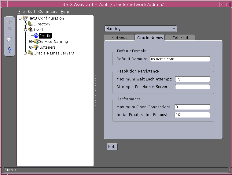

In environments where the client often requests names from a specific domain, it is appropriate to set a default domain in the client's sqlnet.ora file with the NAMES.DEFAULT_DOMAIN parameter.
When a default domain is set, it is automatically appended to any unqualified net service name given in the connect string, and then compared to net service names stored in a tnsnames.ora file or Oracle Names server.
For example, if the client tnsnames.ora file contains a net service name of sales.us.acme.com, the user can enter the following connect string:
CONNECT scott/tiger@sales
In this example, sales gets searched as sales.us.acme.com.
If the connect string includes the domain extension, such as in CONNECT scott/tiger@sales.acme.com, the domain is not appended. If a net service name in a tnsnames.ora file or Oracle Names server is not domain qualified and this parameter is set, the net service name must be entered with a dot ("."). For example, if domain is set to us.acme.com and the client tnsnames.ora file contains a net service name of sales, the user would enter the following connect string:
To specify a default domain:
The sqlnet.ora file should contain an entry that looks like the following:
names.default_domain=com

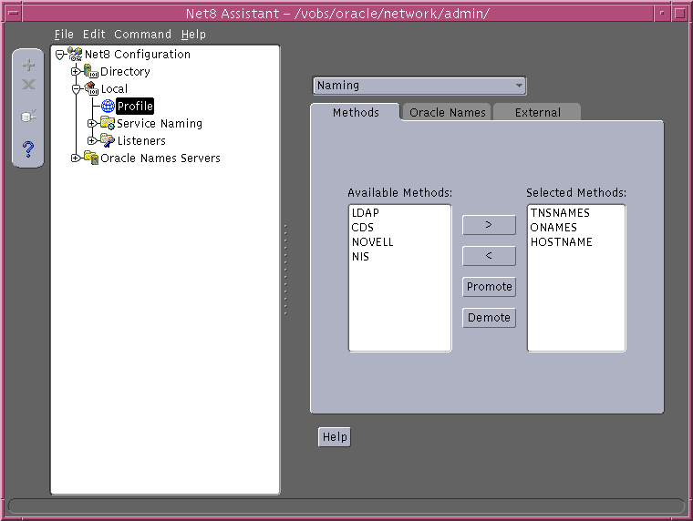

After naming methods are configured, as described in Chapter 6, they must be prioritized. The naming method at the top of the list is used first to resolve a net service name. If it cannot resolve the net service name, the second method in the list is used to resolve the net service name.
To specify the order of naming methods:
Available naming methods are described in the following table:
| Naming Method | Description |
TNSNAMES |
Net service names are resolved using the |
LDAP |
Net service names and database service names are resolved through a directory server. |
ONAMES |
Net service names and database service names are resolved centrally, through an Oracle Names server. |
HOSTNAME |
Net service names are resolved using the host naming method. Certain criteria must be met to use host naming. See Also: "Configuring the Host Naming Method" |
CDS |
This naming method is available with Oracle Advanced Security option. |
NDS |
Novell Directory Services (NDS) |
NIS |
Network Information Service (NIS) |
The naming method moves to the Selected Methods list.
The sqlnet.ora file updates with the NAMES.DIRECTORY_PATH parameter:
names.directory_path=(onames, tnsnames)

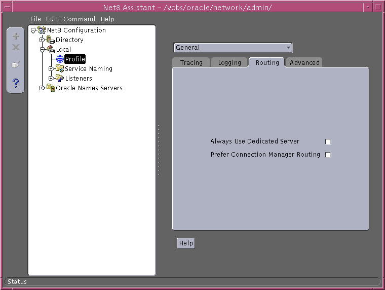

Clients and servers acting as clients can be configured so connection requests are directed to a specific process at all times. The sqlnet.ora file parameters described in the following table can be used to route connection requests:
To route connection requests:

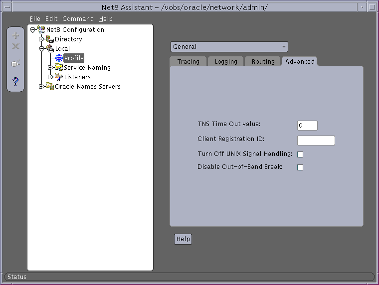

The sqlnet.ora file can be configured with the following advanced parameters:
To set advanced features for clients:

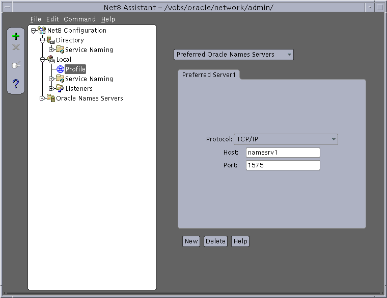

If you are using Oracle Names as a naming method, you can specify the name and address of preferred Oracle Names servers to take precedence over any other available Oracle Names server addresses. Net8 routes name resolution requests to each preferred Oracle Names Server until a response is received.
Preferred Oracle Names servers are an alternative to using the Discover Oracle Names Servers command in Net8 Assistant or the REORDER_NS command in the NAMESCTL control utility. These commands create a list of Oracle Names servers based on what is available throughout the network and ranks them in the order of fastest response time. Preferred Oracle Names servers override any other Oracle Names servers found during the discovery process. Once you have initially discovered an Oracle Names server, you may want to delete preferred Oracle Names servers.
See Also:
To specify a preferred Oracle Names server:
The sqlnet.ora file updates with the NAMES.PREFERRED_SERVERS parameter:
names.preferred_servers= (address=(protocol=tcp) (host=namesrv1)(port=1575))

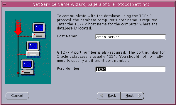

Client support is accomplished by creating two addresses, the first for the Oracle Connection Manager and the second for the listener. Configuration varies according to naming method, as described in the following table:
| Naming Method | Procedure |
Local Naming and Directory Naming |
An address list must be created, where the first address must be for the Oracle Connection Manager, and the second address must be for the listener. In order to have the client connect to the Oracle Connection Manager first and have the Oracle Connection Manager then connect to the listener, the SOURCE_ROUTE parameter must be set. See Also: "Configuring Clients for Oracle Connection Manager" to configure the Oracle Connection Manager and listener addresses |
Oracle Names |
Oracle Names servers are automatically updated with the listener and Oracle Connection Manager addresses.
In order for a client using an Oracle Names server to send requests to Oracle Connection Manager, the USE_CMAN=TRUE parameter must be set in the |

sqlnet.ora file on machines where each Oracle Names server resides. To set this parameter, follow the procedure in "Routing Connection Requests".
tnsnames.ora file or a directory, the protocol addresses and the SOURCE_ROUTE parameter must be set. To configure the local or directory naming methods for Oracle Connection Manager, perform these tasks:
Task 1: Configure an Oracle Connection Manager Address
To configure an Oracle Connection Manager address:

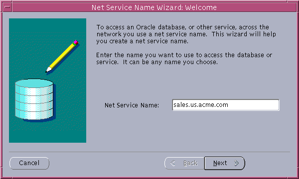

The Net Service Name Wizard starts.
If the destination service is Oracle release 8.1, click (Oracle8i), and enter a service name in the Service Name field. If destination service is Oracle release 8.0 or version 7 database, click (Oracle8 or Previous), and enter an Oracle System Identifier (SID) in the Database SID field.
See Also:
"Understanding Connect Descriptors" for further information about setting the service name string |
The new net service name and the Oracle Connection Manager address is added to the Service Naming folder.
After the Oracle Connection Manager address is specified, create an address for the listener, so that the Oracle Connection Manager can connect to the server.
To configure the listener address:
Notice the Oracle Connection Manager address is displayed in the Address 1 tab:
A new address tab displays.
This option sets SOURCE_ROUTE=ON. It tells the client to connect to the first address, the Oracle Connection Manager, and from the first address to the second address, the listener.
Note: There is not an option that supports client load balancing and connect-time failover options with Oracle Connection Manager's source routing feature within the same address list. When SOURCE_ROUTE is set, the first address is for the client connection to an Oracle Connection Manager and the second address is for the Oracle Connection Manager connection to a listener. Client load balancing and connect-time failover are disabled when SOURCE_ROUTE is set. It is possible to manually configure client load balancing and connect-time failover with source routing for multiple address lists. See "Examples". |

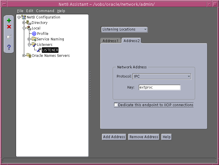

The listener can be configured to listen for external procedure calls. When a PL/SQL or SQL application calls an external procedure, the listener launches a network session-specific process called extproc. Through the listener service, PL/SQL passes the following information to extproc:
extproc then loads the shared library and invokes the external procedure.
By default, Net8 Configuration Assistant configures connections to external procedure during server installation. For environments where the connection information do not exist, edit the listener.ora file and tnsnames.ora files, located in $ORACLE_HOME/network/admin on UNIX and ORACLE_HOME\network\admin on Windows platforms, as follows:
listener.ora file. The following procedures describes creating an IPC address:
-On UNIX, run netasst from $ORACLE_HOME/bin.
-On Windows NT, choose Start > Programs > Oracle - HOME_NAME > Network Administration > Net8 Assistant.
extproc.

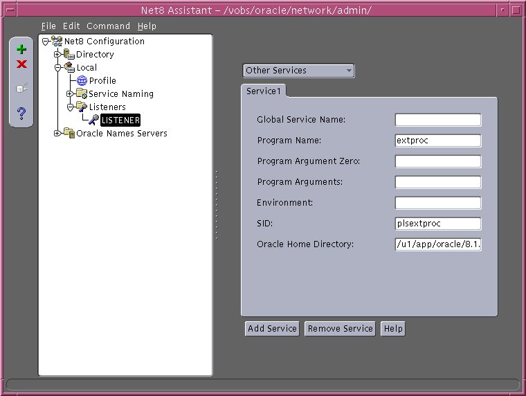

extproc in the listener.ora file, including the following parameters:
To configure the SID_NAME, ORACLE_HOME, and PROGRAM parameters:
extproc in the Program Name field, a SID, such as plsextproc, in the SID field, and the Oracle home where the extproc executable resides in the Oracle Home field,
The listener.ora file updates with external procedures, as shown in the following:
listener= (address= (protocol=ipc) (key=extproc)) sid_list_listener (sid_list= (sid_desc= (sid_name=plsextproc) (oracle_home=/u1/app/oracle/8.1.6) (program=extproc)))

Heterogeneous Services are an integrated component within the Oracle server, and provides the generic technology for accessing non-Oracle systems from the Oracle server. Heterogeneous Services enable you to:
While Heterogeneous Services provides the generic technology in the Oracle server, a Heterogeneous Service agent is required to access a particular non-Oracle system.
To initiate a connection to the non-Oracle system, the Oracle server starts an agent process through the listener on the gateway. For the Oracle server to be able to connect to the agent, perform the following steps:
listener.ora file:
To configure the SID, ORACLE_HOME, and PROGRAM parameters:
The listener.ora file updates information about the Heterogeneous Services, as shown in the following:
sid_list_listener= (sid_list= (sid_desc= (sid_name=salesdb) (oracle_home=/home/oracle/megabase/8.1.6) (program=tg4mb80)))
The tnsnames.ora file updates with the new net service name configured for Heterogeneous Services, as shown in the following:
megabase6_sales= (description= (address=(protocol=tcp)(host=dlsun206)(port=1521)) (connect_data= (service_name=sales6) (hs=ok)))
Oracle Rdb is a database for Digital's 64-bit platforms. With Net8, Oracle Rdb servers appears the same way to clients as Oracle8i databases. Because Oracle Rdb has its own listener, the client interacts with Rdb in the same manner as it does with Oracle7.
To initiate a connection to an Oracle Rdb, set up a net service name to connect to the Oracle Rdb database using the parameters described in the following table:
To configure a client for an Oracle Rdb database, use Net8 Assistant:
The tnsnames.ora file updates with the new net service name configured for the Oracle Rdb database, as shown in the following:
alpha5= (description= (address=...) (connect_data= (service_name=generic) (rbd_database=[.mf]mf_personnel.rdb) (global_name=alpha5)))
In the following example, TYPE_OF_SERVICE is used to load balance between an Oracle Rdb database service or Oracle database service:
alpha5= (description_list= (description= (address=...) (connect_data= (service_name=generic) (rbd_database=[.mf]mf_personnel.rdb) (global_name=alpha5))) (description= (address=...) (connect_data= (service_name=sales.com)) (type_of_service=oracle8_database))
