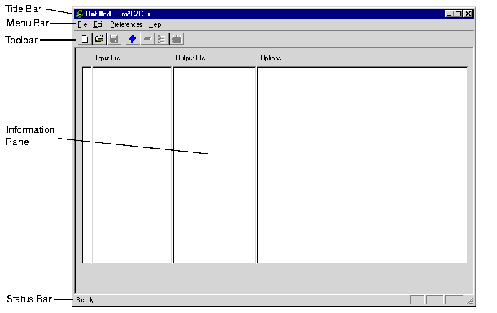

To start the graphical user interface, choose Start > Programs > Oracle - HOME_NAME > Application Development > Pro C_C++.

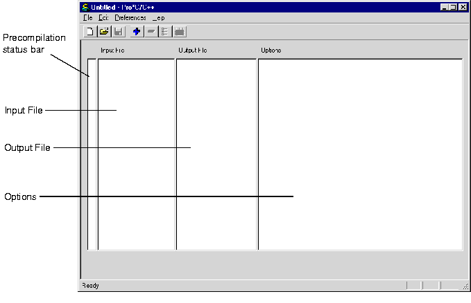

The Pro*C/C++ precompile environment contains five elements noted in the following illustration:
The title bar displays the name of the Pro*C/C++ project. If you have not assigned a name to the current project, the word "Untitled" appears instead.
The menu bar contains the following menus:

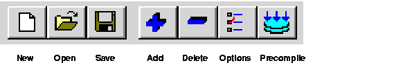

The toolbar enables you to execute commands by clicking a button:
The information pane consists of four elements noted in the following illustration:
Look for one of the three status icons in the precompilation status bar after the precompile process is complete.
Double clicking a status icon opens the Precompilation Status dialog box. This dialog box provides detailed information on the reason for a warning or failure.
The status bar at the bottom of the window displays information about the progress of a precompilation. The status bar also identifies the purpose of a toolbar button or menu command when you place the mouse pointer over the toolbar button or menu command.

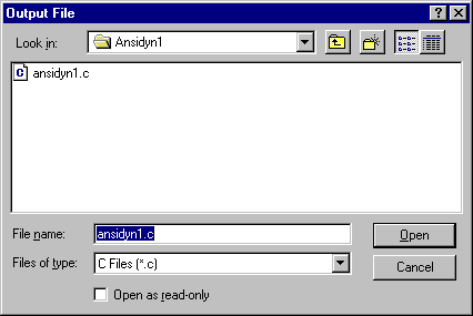

This setting only affects input files that you add later. An existing output file name will not change. However, you can change an existing output file name by double-clicking the output file and entering a new name.

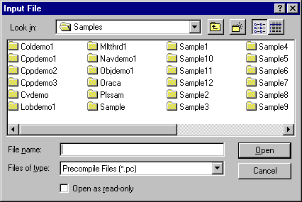

.pc files. Use the Ctrl key and the mouse to select files that are not adjacent.

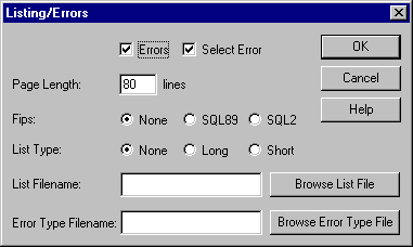

The settings include the type of error information generated and the name of the list file.

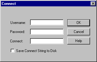

If you selected semantics or full for the SQL Check option in the Options dialog box, you may need to specify database connection information to the Oracle database. You do not need to connect to the Oracle database if every table referenced in a data manipulation statement or PL/SQL block is defined in a DECLARE TABLE statement.

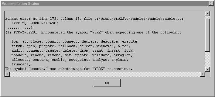

Precompiling can result in success, success with warning(s), or failure. When precompiling is finished, check the precompilation status bar.
If you see a yellow check or a red X, double-click the icon in status bar. The Precompilation Status dialog box appears. This dialog box lists warning messages or reasons why the precompilation failed. For example:
Switch to your development environment to fix the problem(s). After you correct the errors, precompile again.
