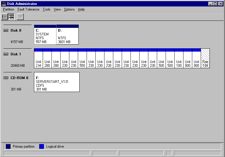

The Disk Administrator window below shows two disks.
Disk 1 has an extended partition:
The following table describes the partitions on disk 0 and
disk 1:
| This disk... | Contains... |
Disk 0 |
Two primary partitions |
Disk 1 |
An extended partition with nineteen logical partitions and 134 MB of free space (this disk device includes six physical disk drives) |

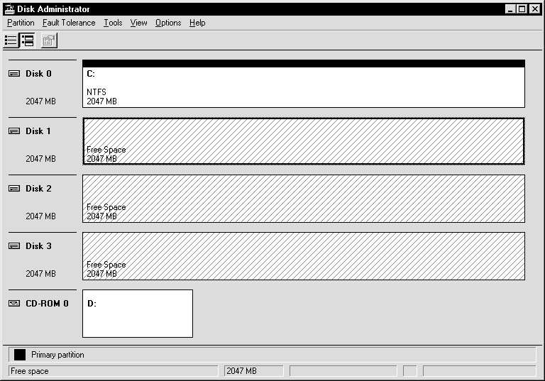

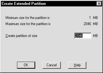

To create an extended partition, perform the following tasks:
The Disk Administrator window appears:
Note the lines display diagonally from top right to the bottom left, indicating unpartitioned devices.
Oracle Corporation recommends you use the entire disk.
The Disk Administrator displays the minimum and maximum
sizes for the extended partition:
Note: Changes you have made are not saved until you choose Commit Changes Now from the Partition menu or quit the Disk Administrator. |
The extended partition is created.

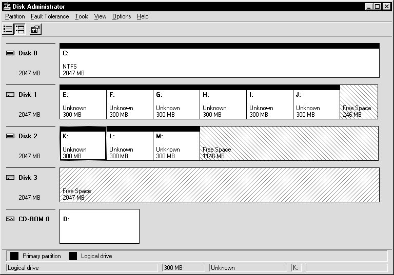

Logical partitions are created on one node of the cluster.
To create logical partitions in an extended partition:
Note: Oracle Corporation recommends you do not create more than 120 logical partitions in an extended partition. |
The Disk Administrator window displays the minimum and maximum sizes for the logical partition.
Note: You can modify file sizes later, but not the raw devices. File sizes cannot expand the size of the raw device. |
A confirmation dialog appears, informing you changes have been made to the disk.
A dialog box appears, informing you the disks have been updated successfully.
To make the changes visible, on all nodes of the cluster,
choose Options > Refresh.

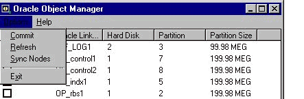

This release includes a new utility, the Oracle Object Link
Manager. Oracle Object Link Manager (GUIORACLEOBJMANAGER.EXE) is a GUI
utility that enables you to assign the logical partitions symbolic link
names. When you install Object Link Manager, a service named ORACLEOBJSERVICE
is installed on each node. This service monitors symbolic link changes
and updates all nodes when changes occur on one node.
To assign symbolic link names, perform the following tasks:
In addition, add additional entries for log files if your cluster contains more than two nodes or your node numbers are not 0 and 1.
C:> GUIORACLEOBJMANAGER.EXE
The Object Link Manager appears.
Repeat steps a to d for any additional edits.
The logical partitions and their symbolic links appear on
the node from which the Oracle Object Manager application is run. Link
names may appear in upper case; however, the names are case insensitive.
To force all active nodes to re-synchronize the links, choose Options > Sync Nodes. Run the Object Link Manager on all nodes to refresh the links.
Note: If you create or remove a partition, you need to reassign links by rerunning the Oracle Object Link Manager on the node you made the disk configuration. |
You do not need to reboot after making changes. However,
if a node is down, it is automatically updated when you reboot. Rebooting
also generates a log file, OOBJSERVICE.LOG in the directory where you installed
the Oracle Object Service.
C:\> ORACLEOBJSERVICE /INSTALL
This installs the ORACLEOBJSERVICE as an automatic startup
type whenever you reboot. This service monitors symbolic link changes and
To remove ORACLEOBJSERVICE, use the following command:
C:\> ORACLEOBJSERVICE /REMOVE
For more information about the install and remove options, use the following command:
C:\> ORACLEOBJSERVICE /HELP

Extended partitions point to raw space on disk drives. Multiple
logical partitions are created in these extended partitions.
Only one extended partition can be created per disk. You
can use the free space in the extended partition to create multiple logical
partitions or use all or part of it when creating volume sets or other
kinds of volumes for fault-tolerance purposes.
You will need to create a logical partition for each log
file, control file, and data file associated with the database. The number
of raw devices created depends on the number of the data files, redo log
files and control files you plan to create. Oracle Corporation recommends
a logical partition of 100 MB.
Note the lines now display diagonally from top left to bottom right, indicating the partition is an extended partition.

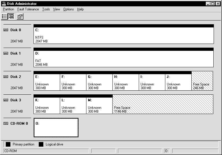

The hard disks that access the shared area may be different
from node to node. The logical partitions, however, that reside on the
hard disks must be identical on all nodes.
For example, Node 1 may look like:
On Node 1, the logical partition E is defined as \Device\Harddisk1\Partition1.
On Node 2, it is defined as \Device\Harddisk2\Partition1. Even though these
map to different disks, they map to the same space on the shared disk.

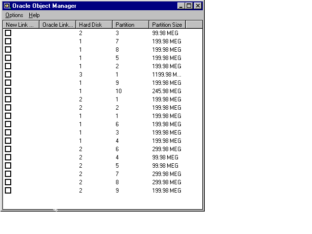

To assign symbolic link names, you create a .TBL file and
import it into the Oracle Object Link Manager. Before you proceed, make
sure you know the partition sizes and the symbolic link names you want
to assign to them.
Use the EXPORTSYMLINKS utility to generate a list of device names and create a file named SYMMAP.TBL.
For example:
EXPORTSYMLINKS /f:MYLINKS.TBL
The following table shows a sample disk layout.
Note: If you add or delete partitions, you must use EXPORTSYMLINKS to export the SYMMAP.TBL file again on the node you configured the disk. The .TBL file will not be valid. |
The IMPORTSYMLINKS utility reads a .TBL file and marks the
hard disk partitions with the symbolic link names. Use the following command
line parameters:
For example:
IMPORTSYMLINKS /f:C:\TEMP\MYLINKS.TBL
Note: IMPORTSYMLINKS detects duplicate names and does not import mappings if duplicates are present. |
C:\> NET START ORACLEOBJSERVICE
The Services dialog box appears.
