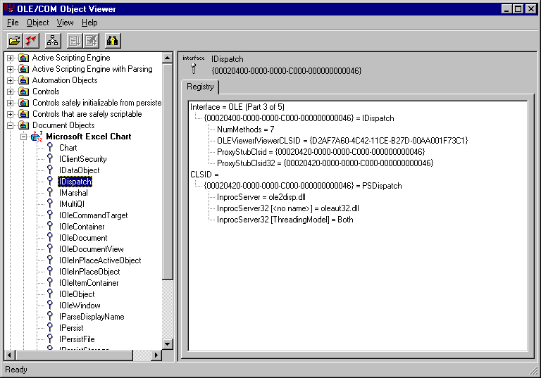

Microsoft provides a tool called the OLE/COM Object Viewer with Microsoft Visual C++ for browsing the properties and methods of COM objects on a local system. This tool enables you to quickly and easily determine the properties and methods that each COM object exposes.
