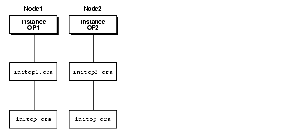

An initialization parameter file is an ASCII text file containing a list of parameters.
In Oracle Parallel Server, some initialization parameters must be identical across all instances. Other parameters, however, can have unique values within each instance. Oracle accommodates both common and unique parameter settings by grouping these parameters into two files, the common (initdb_name.ora) and instance-specific (initsid.ora file) parameter files. If you used Oracle Database Configuration Assistant, these file are already established.
The initsid.ora file uses the IFILE parameter to point to the initdb_name.ora file for common parameters. The initsid.ora file defines the following for each instance:
The sid is the value of the DB_NAME parameter in the initdb_name.ora file and the thread ID. For instance, if the DB_NAME is op, and the first instance has a thread ID of 1, its SID is op1; the second instance uses the SID op2 to identify its instance; and so on.
Example 4-1 and Example 4-2 show the contents of initsid.ora files for two instances with node numbers of 1 and 2 that Oracle Database Configuration Assistant created:
ifile='C:\OracleSW\admin\op\pfile\initop.ora' rollback_segments=(rbs1_1,rbs1_2) thread=1 parallel_server=true instance_name=op1 remote_login_passwordfile=exclusive
ifile='C:\OracleSW\admin\op\pfile\initop.ora' rollback_segments=(rbs2_1,rbs2_2) thread=2 parallel_server=true instance_name=op2 remote_login_passwordfile=exclusive
The parameters are described in the following table:

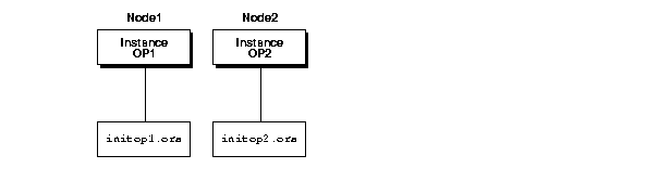

The initdb_name.ora file is called by the individual parameter files through the IFILE parameter setting in initsid.ora file.
All instances must use the same common file. The instance-specific parameter file is optional. When using the instance-specific parameter file, the IFILE parameter within this file must point to the common file using a complete path name.
Example 4-3 shows a initdb_name.ora file (initop.ora) created for a Hybrid database through Oracle Database Configuration Assistant:
