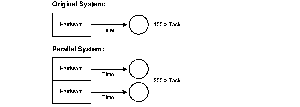

Scale-up is the factor that expresses how much more work can be done in the same time period by a larger system. With added hardware, a formula for scaleup holds the time constant, and measures the increased size of the job which can be done.
If transaction volumes grow and you have good scale-up, you can keep response time constant by adding hardware resources such as CPUs.
You can measure scaleup using this formula:
Where:
Volume_Parallel |
is the transaction volume processed in a given amount of time on a parallel system. |
For example, if the original system processes 100 transactions in a given amount of time and the parallel system processes 200 transactions in this amount of time, then the value of scaleup would be equal to 2. A value of 2 indicates the ideal of linear scaleup: when twice as much hardware can process twice the data volume in the same amount of time.

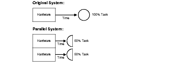

Speed-up is the extent to which more hardware can perform the same task in less time than the original system. With added hardware, speed-up holds the task constant and measures time savings. Figure 8-2 shows how each parallel hardware system performs half of the original task in half the time required to perform it on a single system.
However, you may not experience direct, linear speed-up. Instead, speed-up may be more logarithmic. That is, assume the system can perform a task of size "x" in a time duration of "n". But for a task of size 2x, the system may require a time duration of 3n.

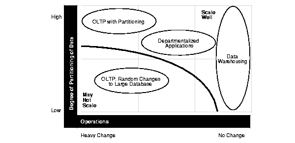

Figure 8-3 illustrates the relative scalability of different application types. Data warehousing applications, depicted by the left-most bubble, typically scale well since updates are less common and the degree of partitioning is higher than other application types. OLTP and departmentalized applications with partitioning and increasing rates of change also scale well.
OLTP applications that make random changes to large databases were historically not considered good parallel server candidates. Such applications, however, are becoming more scalable because they use advanced inter-node communication channels such as an interconnect. This is particularly true if, for example, a table is modified on one instance and then another instance reads the table. Such configurations are now much more scalable than in previous releases.
