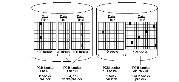

Figure 7-1 shows an example of mapping blocks to PCM locks for the parameter value GC_FILES_TO_LOCKS = "1=60:2-3=40:4=140:5=30".
In data file 1 shown in Figure 7-1, 60 PCM locks map to 120 blocks, which is a multiple of 60. Each PCM lock therefore covers two data blocks.
In data files 2 and 3, 40 PCM locks map to a total of 160 blocks. A PCM lock can cover either one or two data blocks in data file 2, and two or three data blocks in data file 3. Thus, one PCM lock may cover three, four, or five data blocks across both data files.
In data file 4, each PCM lock maps exactly to a single data block, since there is the same number of PCM locks as data blocks.
In data file 5, 30 PCM locks map to 170 blocks, which is not a multiple of 30. Each PCM lock therefore covers five or six data blocks.
Each of the PCM locks illustrated in Figure 7-1 can be held in either read-lock mode or read-exclusive mode.

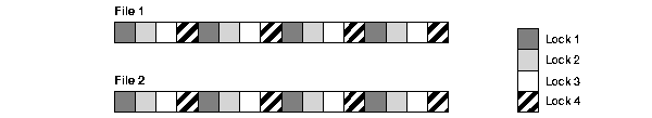

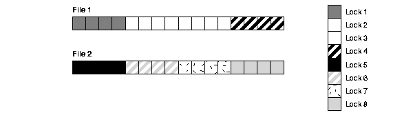

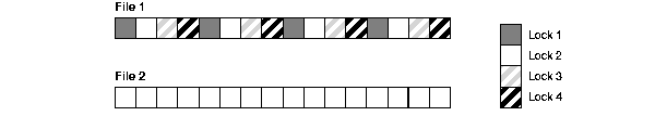

Examples 5, 6, and 7 show the results of specifying various values of GC_FILES_TO_LOCKS. In the examples, files 1 and 2 each have 16 blocks of data.
GC_FILES_TO_LOCKS="1-2=4"
In this example four locks are specified for files 1 and 2. Therefore, the number of blocks covered by each lock is 8 ((16+16)/4). The blocks are not contiguous.

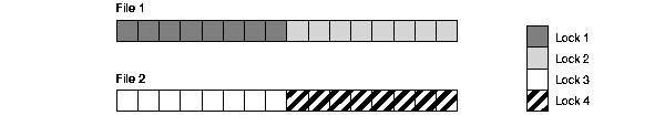

GC_FILES_TO_LOCKS="1-2=4!8"
In this example, four locks are specified for files 1 and 2. However, the locks must cover 8 contiguous blocks.
GC_FILES_TO_LOCKS="1-2=4!4EACH"
In this example four locks are specified for file 1 and four for file 2. The locks must cover four contiguous blocks.

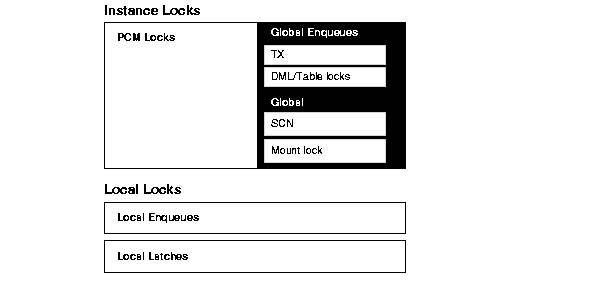

This section explains how Oracle uses non-PCM locks to manage locks for transactions, tables, and other entities within an Oracle environment. Prefixes for each type of lock, such as "TX" for transaction locks and "TM" for table locks, refer to the naming scheme Oracle uses to identify them.
Figure 7-9 highlights non-PCM locks in relation to other locks used in Oracle.
Whereas PCM locks are static (you allocate them when you design your application), non-PCM locks are very dynamic. Their number and corresponding space requirements will change as your system's initialization parameter values change.
