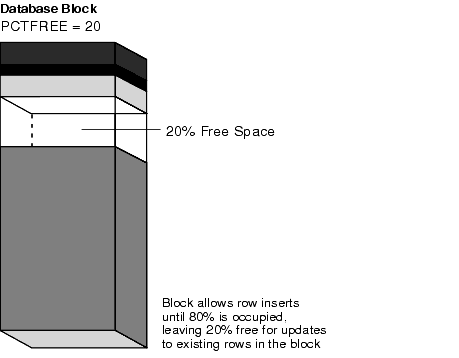

The PCTFREE Parameter
The PCTFREE parameter is used to set the percentage of a block to be reserved for possible updates to rows that already are contained in that block. For example, assume that you specify the following parameter within a CREATE TABLE statement:
PCTFREE 20
This indicates that 20% of each data block used for this table's data segment will be kept free and available for possible updates to the existing rows already within each block. Figure 12-1 illustrates PCTFREE.
Figure 12-1 PCTFREE
Notice that before the block reaches PCTFREE, the free space of the data block is filled by both the insertion of new rows and by the growth of the data block header.
Specifying PCTFREE
The default for PCTFREE is 10 percent. You can use any integer between 0 and 99, inclusive, as long as the sum of PCTFREE and PCTUSED does not exceed 100.

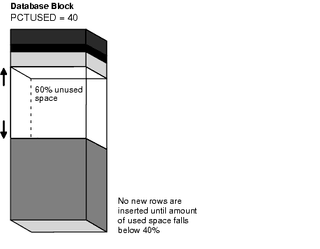

The PCTUSED Parameter
After a data block becomes full as determined by PCTFREE, Oracle does not consider the block for the insertion of new rows until the percentage of the block being used falls below the parameter PCTUSED. Before this value is achieved, Oracle uses the free space of the data block only for updates to rows already contained in the data block. For example, assume that you specify the following parameter within a CREATE TABLE statement:
PCTUSED 40
In this case, a data block used for this table's data segment is not considered for the insertion of any new rows until the amount of used space in the block falls to 39% or less (assuming that the block's used space has previously reached PCTFREE). Figure 12-2 illustrates this.
Figure 12-2 PCTUSED
Specifying PCTUSED
The default value for PCTUSED is 40 percent. After the free space in a data block reaches PCTFREE, no new rows are inserted in that block until the percentage of space used falls below PCTUSED. The percent value is for the block space available for data after overhead is subtracted from total space.
You can specify any integer between 0 and 99 (inclusive) for PCTUSED, as long as the sum of PCTUSED and PCTFREE does not exceed 100.

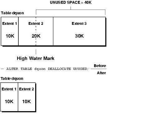

Viewing the High Water Mark
Prior to deallocation, you can use the DBMS_SPACE package, which contains a procedure (UNUSED_SPACE) that returns information about the position of the high water mark and the amount of unused space in a segment.
Within a segment, the high water mark indicates the amount of used space, or space that had been formatted to receive data.You cannot release space below the high water mark (even if there is no data in the space you wish to deallocate). However, if the segment is completely empty, you can release space using the TRUNCATE...DROP STORAGE statement.
See Also:
The DBMS_SPACE package is described in Oracle8i Supplied PL/SQL Packages Reference.
Issuing Space Deallocation Statements

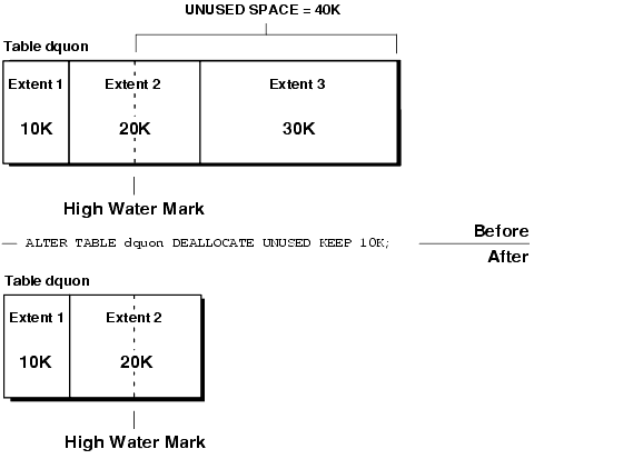

The following statements deallocate unused space in a segment (table, index or cluster). The KEEP clause is optional.
ALTER TABLE table DEALLOCATE UNUSED KEEP integer;
ALTER INDEX index DEALLOCATE UNUSED KEEP integer;
ALTER CLUSTER cluster DEALLOCATE UNUSED KEEP integer;
When you explicitly identify an amount of unused space to KEEP, this space is retained while the remaining unused space is deallocated. If the remaining number of extents becomes smaller than MINEXTENTS, the MINEXTENTS value changes to reflect the new number. If the initial extent becomes smaller, the INITIAL value changes to reflect the new size of the initial extent.
If you do not specify the KEEP clause, all unused space (everything above the high water mark) is deallocated, as long as the size of the initial extent and MINEXTENTS are preserved. Thus, even if the high water mark occurs within the MINEXTENTS boundary, MINEXTENTS remains and the initial extent size is not reduced.

A table consists of three extents. The first extent is 10K, the second is 20K, and the third is 30K. The high water mark is in the middle of the second extent, and there is 40K of unused space. Figure 12-3 illustrates the effect of issuing the following statement:
ALTER TABLE dquon DEALLOCATE UNUSED
All unused space is deallocated, leaving table DQUON with two remaining extents. The third extent disappears, and the second extent size is 10K.
Figure 12-3 Deallocating All Unused Space
But, if you had issued the following statement specifying the KEEP keyword, then 10K above the high water mark would be kept, and the rest of the unused space would be deallocated from DQUON.
ALTER TABLE dquon DEALLOCATE UNUSED KEEP 10K;
In effect, the third extent is deallocated and the second extent remains intact.
Figure 12-4 illustrates this situation.
Figure 12-4 Deallocating Unused Space, KEEP 10K
